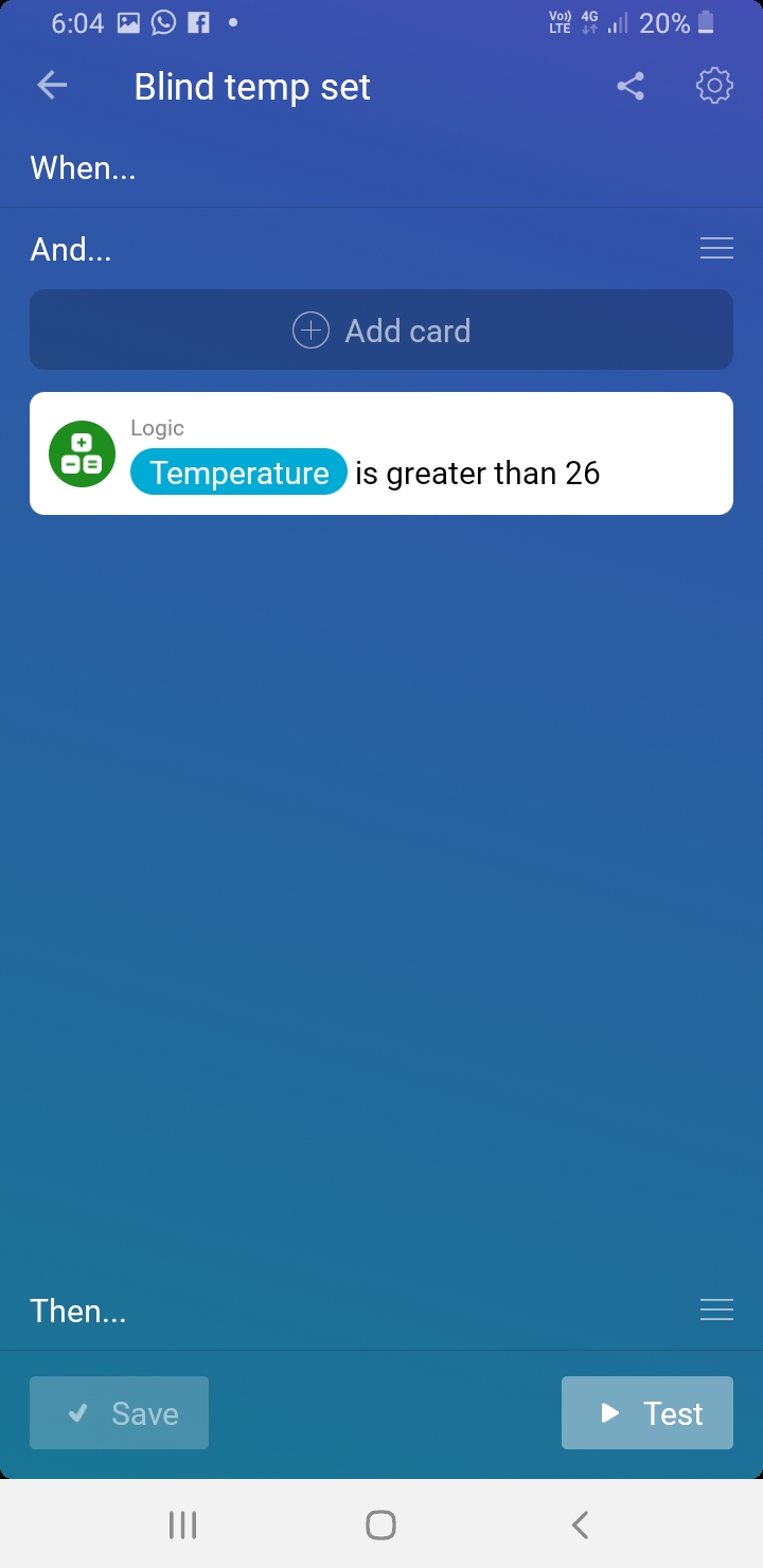

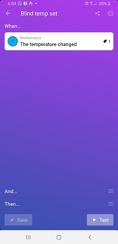

This is the flow to set and unset the „Temp“ variable:
That looks good.
I assume you have selected the correct temperature tag (from the Aeotec Multisensor 6) in the logic card.
But this still doesn’t explain why the flow works when it is triggered manually and doesn’t run automatically.

This is how it is set up at the moment.
What could be wrong with it?
Did you follow @RoyWissenburg advice?
If the properties (temperature and lux) have been selected from the right devices, the flow should actually work.
