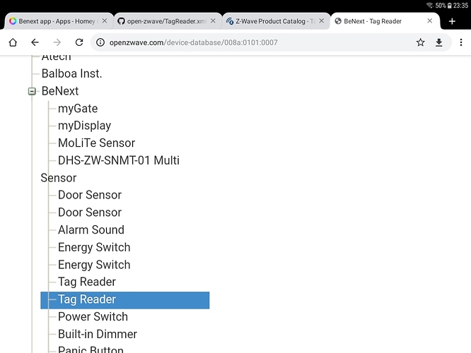

You do have the same one as I have. But 257 is 0101. That’s probably why it is not recognized.
I have been checking the manuals at benext. To include the tagreader 500 us, you have to use the enter key. To include the tagreader eu. You have to use the tamper switch on the back. The app is mentioning tagreader 500 but the instructions are for the old tagreader. Something is mixed up. Extra complication is the fact there are two old tagreaders with resp. Id 0100 and 0101. Sebastien has the same one as I have. Maybe that is the one that has been sold the last years. When I look at the website of benext It looks as if tagreader 500 is for US and tagreader is for EU.
I looked into it and it should also work with the Tag Reader 500 Driver. So I added the product IDs.
I send a PR for the Beta Version
@Robin_van_Kekem has to approve it and send it to Homey Apps where Athom has to approve it.
