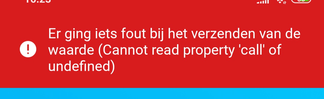

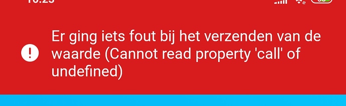

Also the Heating Controller is not working anymore.
It still receives heatpoints but can not send them.
Anyone else with this problem?
same problem, reported this on github also a lot of other users but there is no respond from the developer.
After 1 month still no solution

Will be fixed soon
That is exactly what the developer also reported over 1 month ago, but nothing seems to happening, no feedback, replies etc . (i do not call 1 month soon btw)
Over 1 month ago it was still sunny and warm so no hurry there, but now it is getting colder each day and i would like to use the thermostat again to turn on the heat so now and then.
