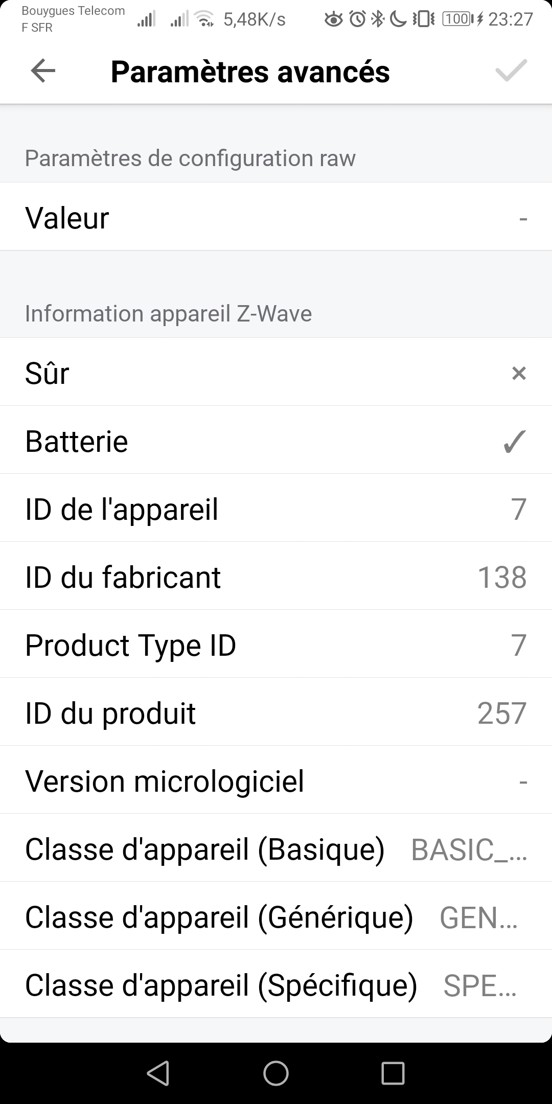

What is the old tagreader? Is that tagreader 500. When I try to add it. The message is that no app is found. Adding as simple device…

There is a “Tagreader” and the newer one “Tagreader 500”
They look exactly the same but have other hardware or firmware inside.
Could you please provide the Manufacturer-ID, Device-Type-ID and Device-ID which can be found in the device under advanced settings?

Device Id 36
Manufacturer id 138
Product type Id 7
Product Id 257

That’s strange.
For the old tagreader the product id should be 256
and for the new “tagreader 500” it should be 512.
I guess it is the older one?
Between them there are differences with the command classes/command class versions.

There is not much information on the device itself. On the back plane it is called tag reader and it is not zwave plus. The numbers are from homey for the simple device that is added.
