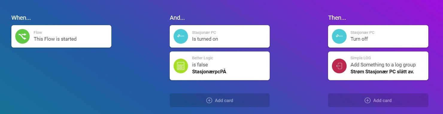

Flow 3’
If after one minute, power is still less than 75 watts and the Boolean Variable is false, shuts the pc off and adds a line to my Simple log.

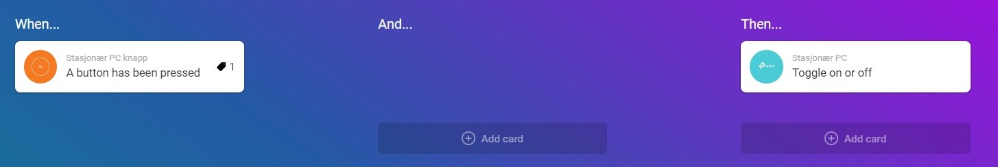

Flow 4
For the button:
button

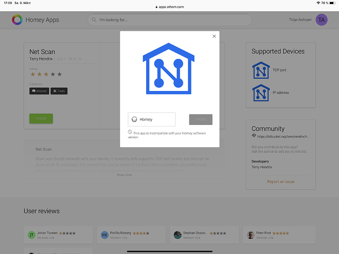

@Willybits,
The App is incompatible in V2.
No it is not, I am using it in V2
Netscan :0.3.1
@Willybits,
when i want to install the app it says the app is incompatible with your software.
And u downloaded it from the appstore without editing the app.json file for wrong compatibility?
It has been on my homey for over a year now, so I have not installed it on V2 myself.
Shame it has not been updated for people to use it on V2 then
Ok, fair enough. So it runs on 2.0 when u got it installed before upgrading to 2.0. When alr on 2.0 the app has wrong compatibility and won’t install.
I’ll have a look, for Smart Presence it was (almost) just enough to up the compatibility…
