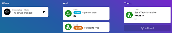

First make the “boolean”. Go to more/logic. Then click the + sign on the top right. Give it a name, i used “Power tv” in this case. Click the type and choose yes/no. Click the save mark on the top right.
Then make 3 flows like this:
This way the boolean will only turn to yes when it was no and vice versa.
The rest of the cards u have to add urself, like turning the lights off. Plz be aware that with the “Turn specific devices on” card u will turn on ALL lights in that zone, in this case ALL lights on the eerste verdieping WILL turn on.
