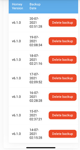

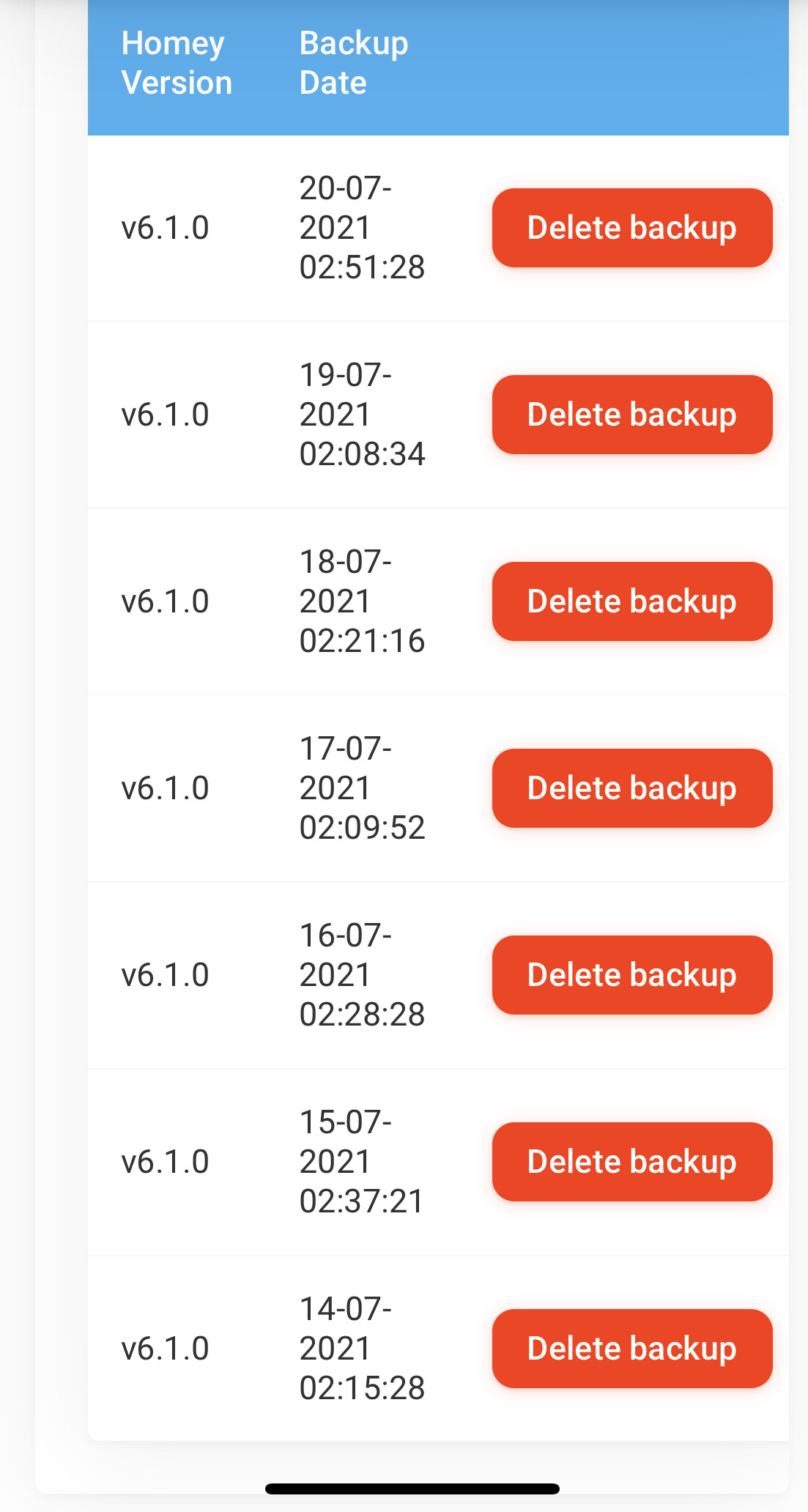

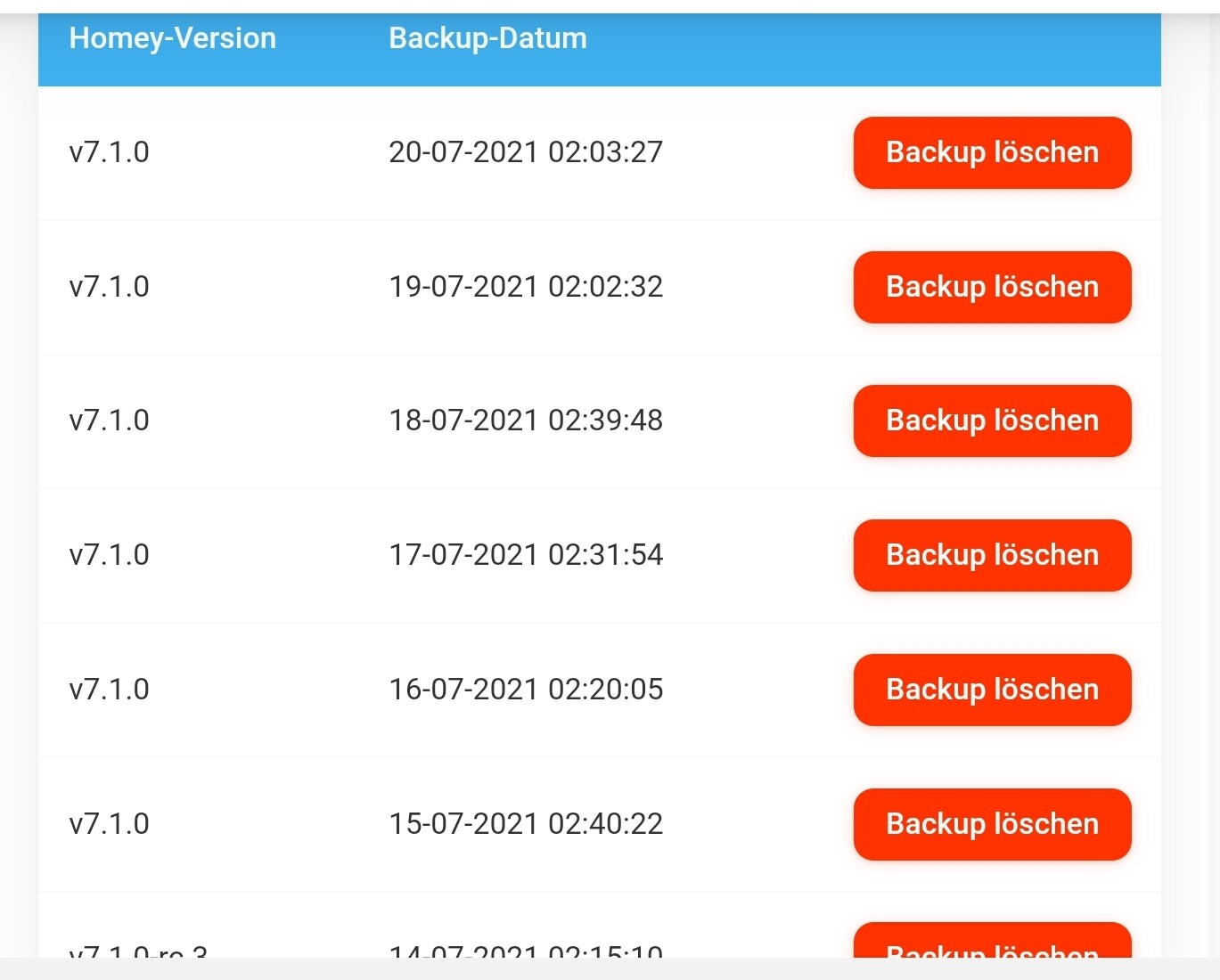

I can not confirm this. Homey does his backups well.
Weird. Wonder why mine doesn’t.
Here also no problems
