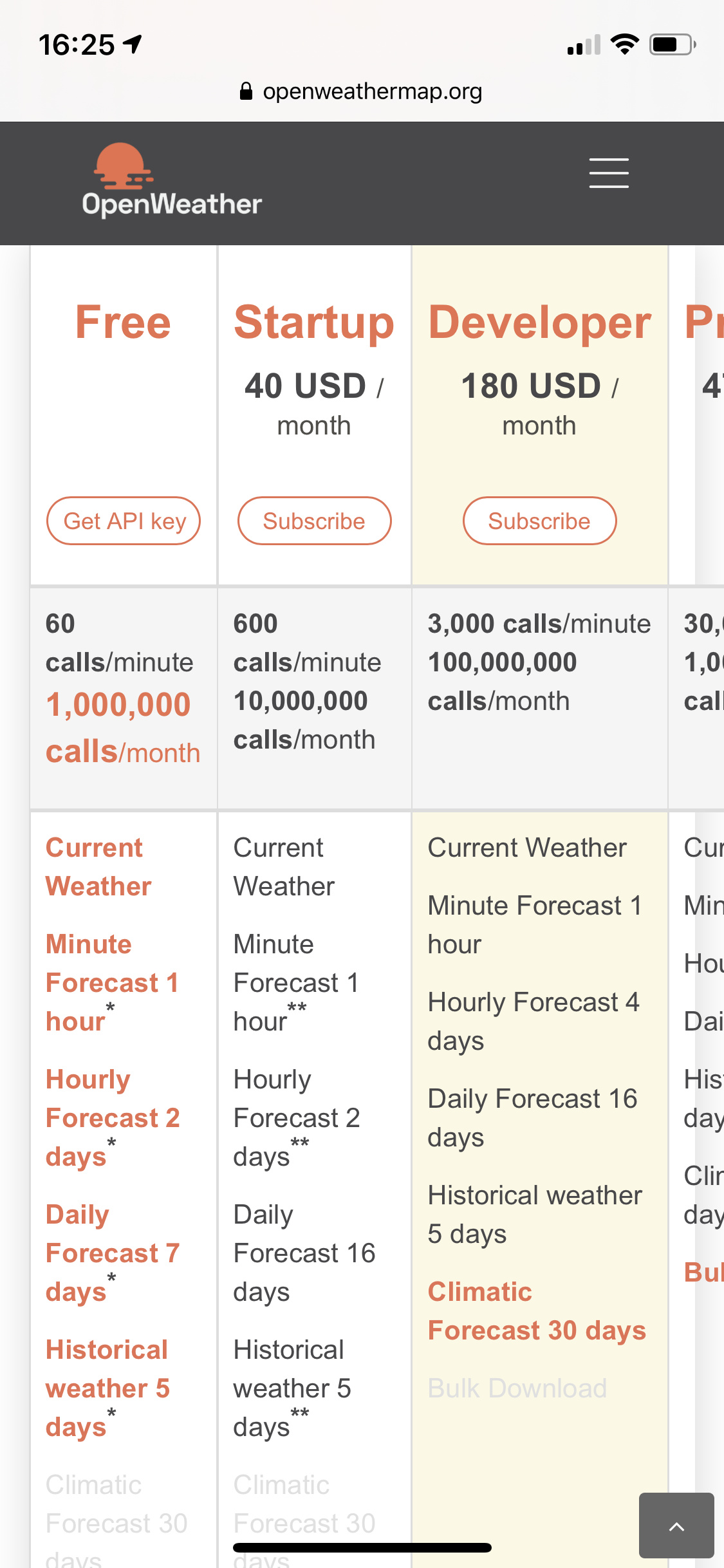

It looks like this discussion became quiet 3 weeks ago. What is the current status? Is this “Testapp” available? I got a Homey 2 days ago and installed this app. Then I created a free API key and spent some time typing it into my tiny phone screen, and only now found this discussion, which seems to suggest that I currently can’t get any weather predictions from this app. Is that right?

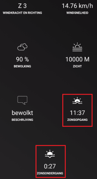

It would be great to use a flow with sunrise and sunset. (WHEN sunrise THEN turn on lamp).
Is there a way to make it happen?
Homey has this function integrated in the “Date & Time” category. So there is no need for an additional app.
I know, but I need it from another location.
I have a paludarium with poison dartfrogs. It would be nice to simulate the weather from their country of origin.
Well this app is giving me the information, but I can not use it in a flow, at least I can not find it…
Shame on me, I completely misunderstood you. :man_facepalming:t3:
I tried to find a way to use the sunrise and sunset but without success, sorry.
