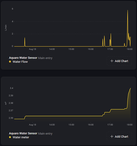

But no water flow or water meter data so far while I made the dishes.

Now my final problem is with Aquaro itself. So far in the 12 hours it has been installed, it has only published battery and RSSI info to the topic and no values on water consumption. This I will need to pick up with Aquaro themselves.
