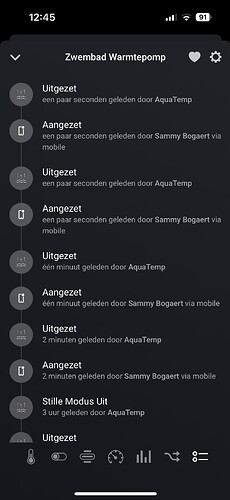

I have a weird issue now. Every action i try to switch on the heatpump (flow or manually) is overridden after a few seconds by the app itself. So i can’t switch it on now
Hmm does it work from the official app?
Otherwise please send a diagnostics report so I can look at some log.
This is very similar to what I have reported earlier as strange behaviour. For me it happens rarely.
