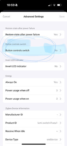

About a month ago, the driver was updated to support the “decoupled/detached” mode but I guess I missed it? The label is called “Button controls switch”. I could have sworn I checked the settings again today (I’ve had this tab pinned to come back to for a while…) or maybe my brain was in lizard mode for that 30 seconds! :lizard:

I’m trying to do this but where do you see “Button Controls switch” option? I am using the official Aqara Homey app which brought my switches to Homey.
I have set the switch to wireless mode in the iPhone Aqara app but not sure how to get that functionality in Homey.
In the advanced settings for the device.
Thanks.
My switch was paired to the Aqara hub and then brought over to Homey using Matter. Had to remove it from Aqara and pair it directly to Homey to see those options.
Hmm glad you figured something out! The setting should have been available in the Aqara hub as well but idk what it’s called.
