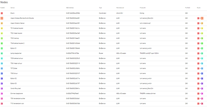

This is my Zigbee network. The Ikea bulb is switched off completely so doesn’t act as router normally.

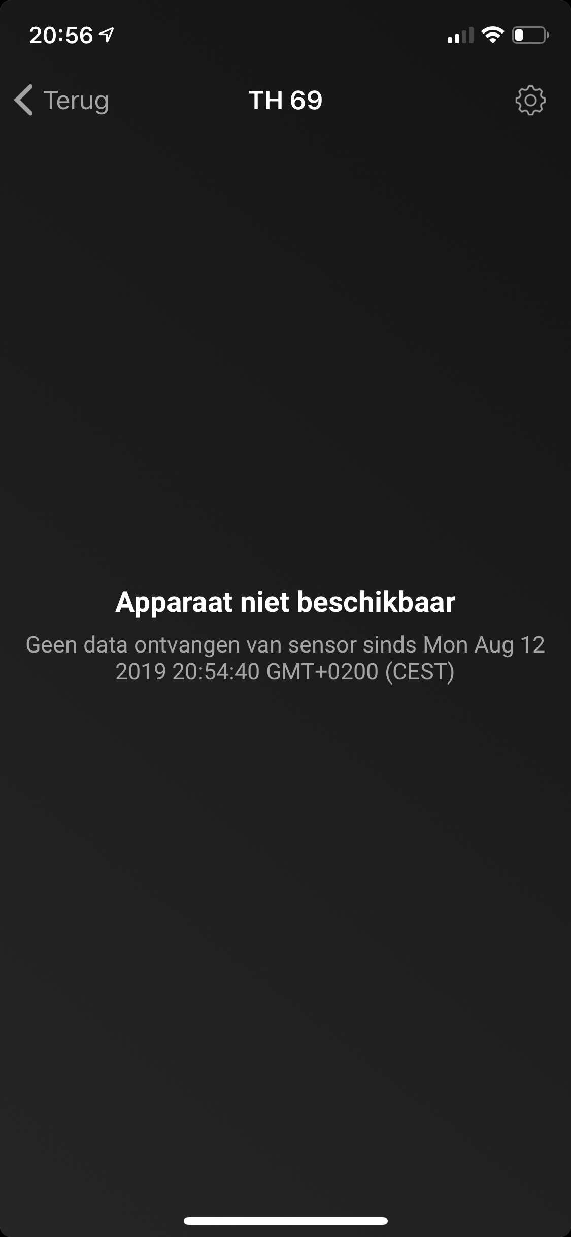

After a few mins i get an error though. Time out i supose. After a few mins it updates again and then error again. But could be bad battery so will replace that tomorow and let you know the result.
Yeah, that is due to range issues. Could be the batteries ineed or some other temp sensor device that occupies the same channel.
