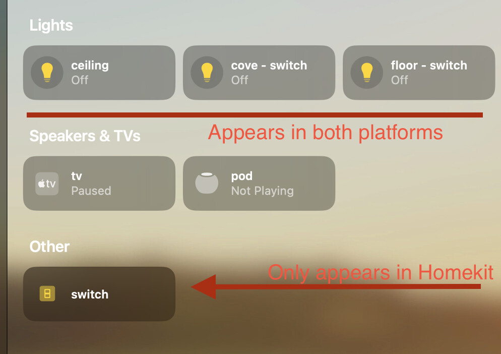

The bottom most, “smart only” button shows up in HomeKit, but only the top 3 physical/smart buttons show up when paired with homey.
Im not sure if it’s relevant but I always pair matter devices to HomeKit first and then pair with homey using matters multi admin.
Anyone have any thoughts on why Homey interprets this matter device slightly differently?
Support was able to point me in the right direction. For this device, there is a flow card specifically under the switch position 3 (L3) with a smart button trigger for each button. including button 4, the smart only one that doesnt appear as a device.
