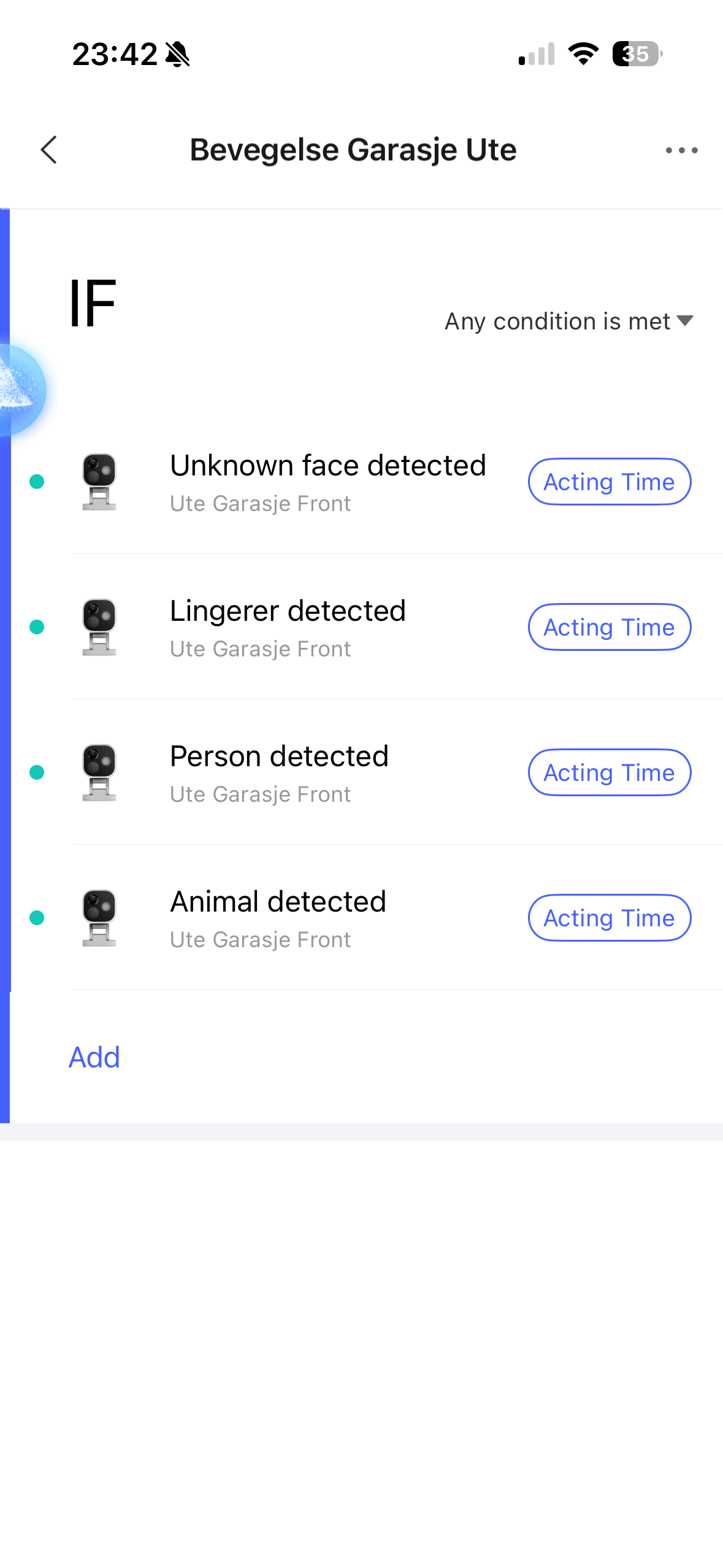

Use signals sync under Connect to Ecosystems and Matter. I use it to automatically turn on outdoor lights when movement is detected. Works like a charm.

@Tim_Marshall how could you add the Aqara hub to homey? I try to do exactly what you did but i cant figure it out. I want to use “person detected” to turn on the light. I cant add the govee light to aqara, anymore. I tried to add it with Matter to the Aqara but i cant getting it running.
Can’t 100% remember but somewhere in the Aqara app settings for the hub there is somewhere to get the matter code for it which you can then add as a matter device.
ah, yes, i found it :slight_smile: Thanks!
Yeah its a bit buried in the menu’s like a lot of Aqara stuff.
