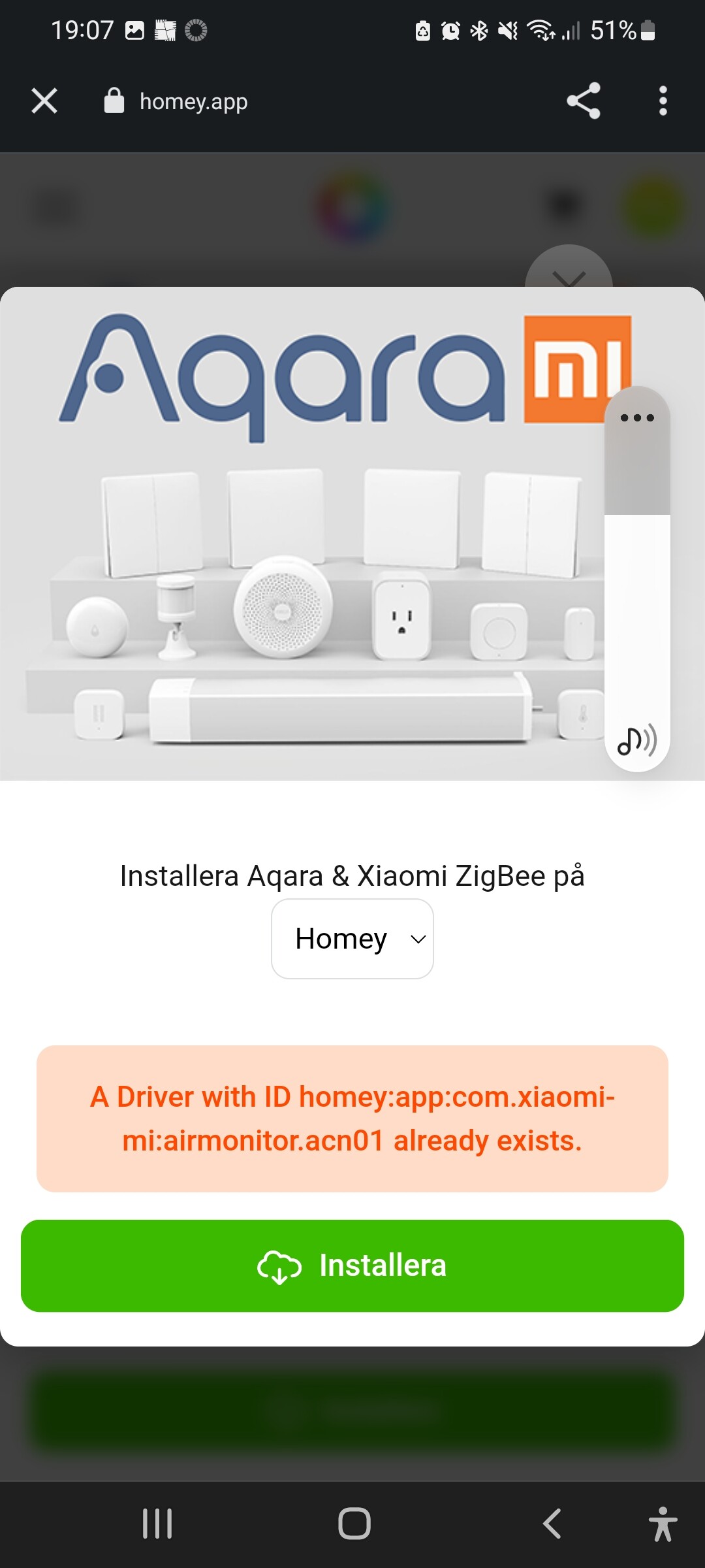

A Driver with ID homey:app:com.xiaomi-mi:airmonitor.acn01 already exists. No app apears on screen. Is it a Homey problem.

When will you receive this text? When I try to Down load app
When do you add a device? can’t call app is not visible
Devices, +, Aqara app, select the device you have and then you get this message? Yes
If so, did you reset Homey or restart the app? Have tried. Nothing happens

I’m getting this now as well on my bridge after the major problem they had with the update on Friday.
They did an update today to get the bridge to work again, but now the Aqara app is removed from my app list even if i still have the devices in my setup.
Try to install it again it gives this error during installation.

and all of my aqara is in this state:

I have create a ticket on the support, it was a problem on Europe servers, you can see the update here:

I got this from the support:
Could you please restart your Homey on the developer website? Please go to Homey Developer Tools and select Restart.
Worked for me to reinstall the app after this and all devices are working again, or at least not red
Thanks you for your returns, i do this, and now, all of my devices is OK
