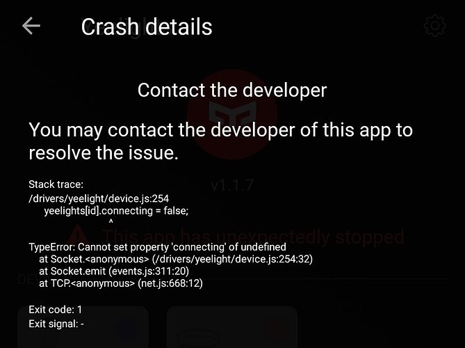

I bought Yeelight Strip today, managed to add it to the app but it got identified as a ceiling light for some reason, I can turn it on/off and dim it, but can’t change colors :frowning:
That means it’s a new model that is not added to the app yet. What is the model identifier under the device settings in the official Yeelight app? I need this to add it to my app.
Is this it? :slight_smile:
Let me know if you need something else. App crashes sometimes, not sure if its because of my lightstrip or not.
5fb958d8-6ed3-4087-a631-96e5060d3802
