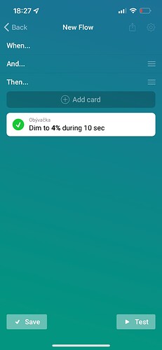

I don’t have this card but similar to yours, this one works.
obrazek
