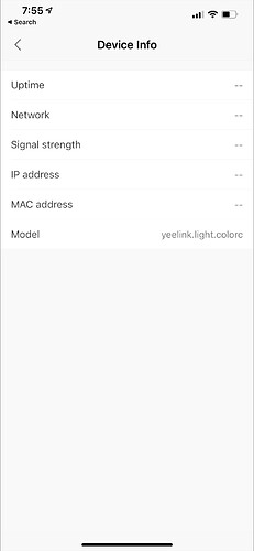

If it’s a new model I’d probably have to add support for it to make sure it has the right capabilities. You can find the model under the device info in the official Yeelight app.
I have bought these lamps too but they don’t seem to be supported by the app. Please let me know what is needed to add support to them?
This is what I see under the device info.

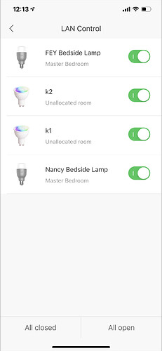

That’s the model type indeed. But if it’s not discovered at all there is something else going on. Did you enable LAN mode?
Lan control is on.
Don’t know then.
What do you suggest I do?
are there any troubleshooting steps or logs that I can collect? The last two srx the lights on my router
