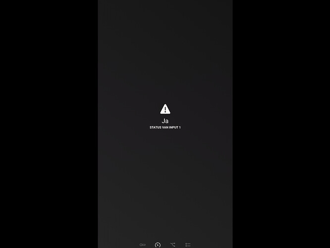

After update Shelly V3.0.18 Shelly 1 goes into alarm at homey when the light switch is turned on.
Hope this will be adjusted soon.

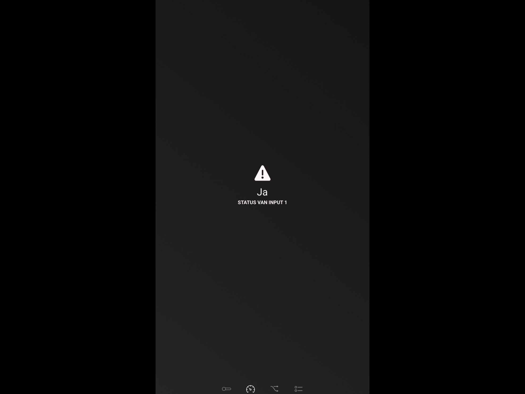

Sorry I can’t find it. After update Shelly V3.0.19, Shelly 1 still goes into alarm at home when the light switch is turned on. All my Shelly, s I have the latest software on the Shelly.
What is exactly the issue? The state of the input is changed when you switch it. It works at intended.
the problem is that if the input is on you will get an alarm, and this is not an alarm. And Homey then reports that there is an alarm in the switch.
Right, I guess that is an unwanted side effect of using the built in capability alarm_generic for showing the input state of the device. I’ll probably improve this some time in the future. For now I’m focusing on getting the app to work properly for users with a large collection of Shellies.
Good to hear that you will solve this later. If you receive notification from users, you can do something with it, you simply cannot experience everything yourself. Good luck with the further development.

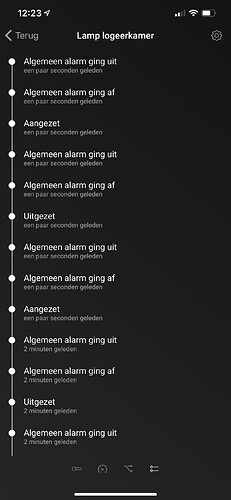

@Phuturist Hi Jelger,
I have the same issue like @JeffreyA :wink:
Edit: I see you are already noticed by other users. I have a lot of Shelly’s using this way, so also a lot of alarms. Hope you will solve this in the near future.

Is it possible to turn of the input state warning? Now I keep having warnings (on my homeydash) that aren’t really alarms to me. I use edge switches for the shelly, so it changes state by every flip. It’s really annoying now. I can understand the use of it, but not for edge switches which change every time.
