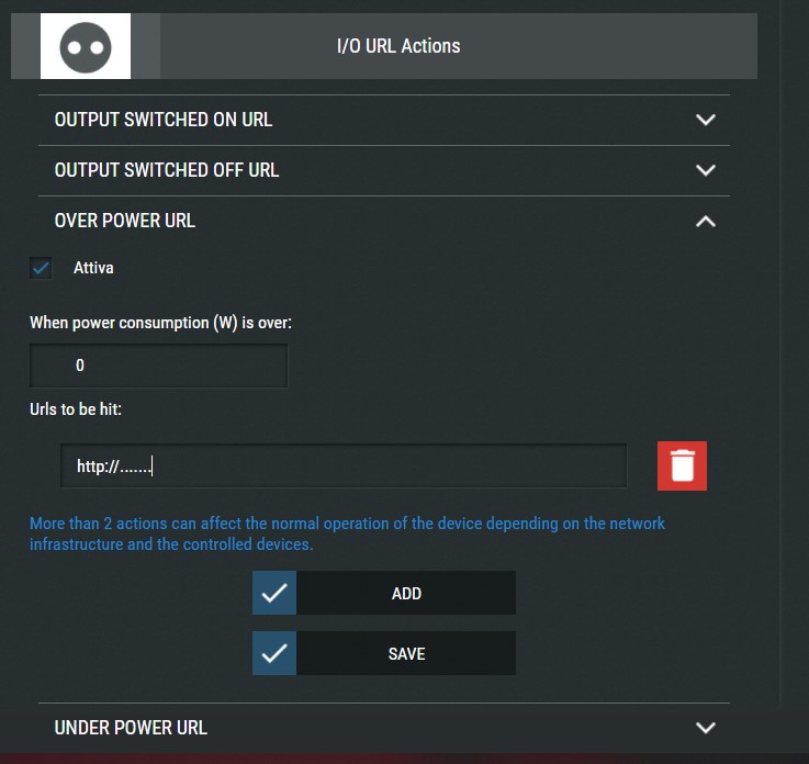

Unfortunatly i don’t find info about homey webhooks, is an app to add or a Homey OS function already present? please can you show me an example how to fire a flow using webhooks?
for example i would like to add in a shelly 1PM an URL action to start a flow, for example for a Shelly EM Overpower URL action that in shelly app is not present.

Guess I misunderstood. As far as I know there is no action url for overpower in the Shelly devices. I might be able to create a custom capability for it though it’s this information is present somewhere else. Submit a feature request on GitHub and I’ll look at it when I have time.
sorry i specify a wrong shelly device.
I have in my hose 3 Shelly EM and in this device i have overpower URL action…
is this a shelly cloud feature or in shelly device?
i would like to put in urls a webhook to run a flow…
or you can enable this in shelly app like button 1 button ?
thanks
You can use http request flow app to trigger any action in Homey by calling designated http request from outside.
The whole action URL’s are deprecated in app version 3.x and replaced by CoAP events. I see there is also a CoAP event for overpowered but I have not implemented it yet. As mentioned you can submit a feature request on Github.
If you wish to solve it with a webhook you can use the internal webhook card wich is available under the logica trigger cards. The information text of that card will tell you how to use it.

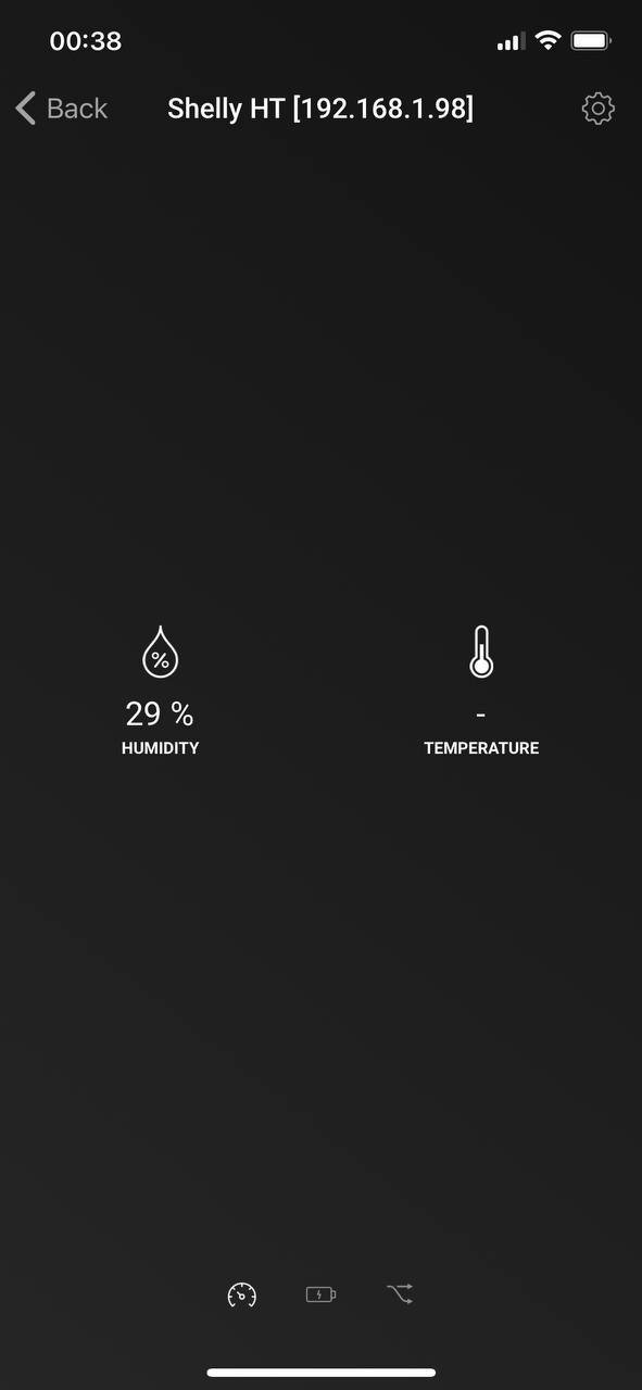

Shelly HT problem,
There is no Maintenance Actions in settings for some reason on this device. Only Advanced Settings and i can setup only user/password. This device doesn’t updates without callbacks.
Same problem on FW 4.2 or 5.
Are you using the 3.x version of the app on firmware 5.x?
on FW5 i used v3.0.7
on FW4.2 i used 1.25.6
i have two different Homeys to test.
On version 3.x there are no maintenance actions anymore. It works differently. I’ll check the code but my guess is that I won’t find anything strange and I don’t own the device myself to test with. The battery operated wifi devices are just not that reliable for integration. But what do you see under the device on version 3.x?
After i touch something, not sure what exactly. I installed/re-installed device many times. It’s updated humidity value and battery.
You probably just have to be patient until the device reports it’s status. As mentioned these battery operated wifi devices are not as swift as powered devices.
