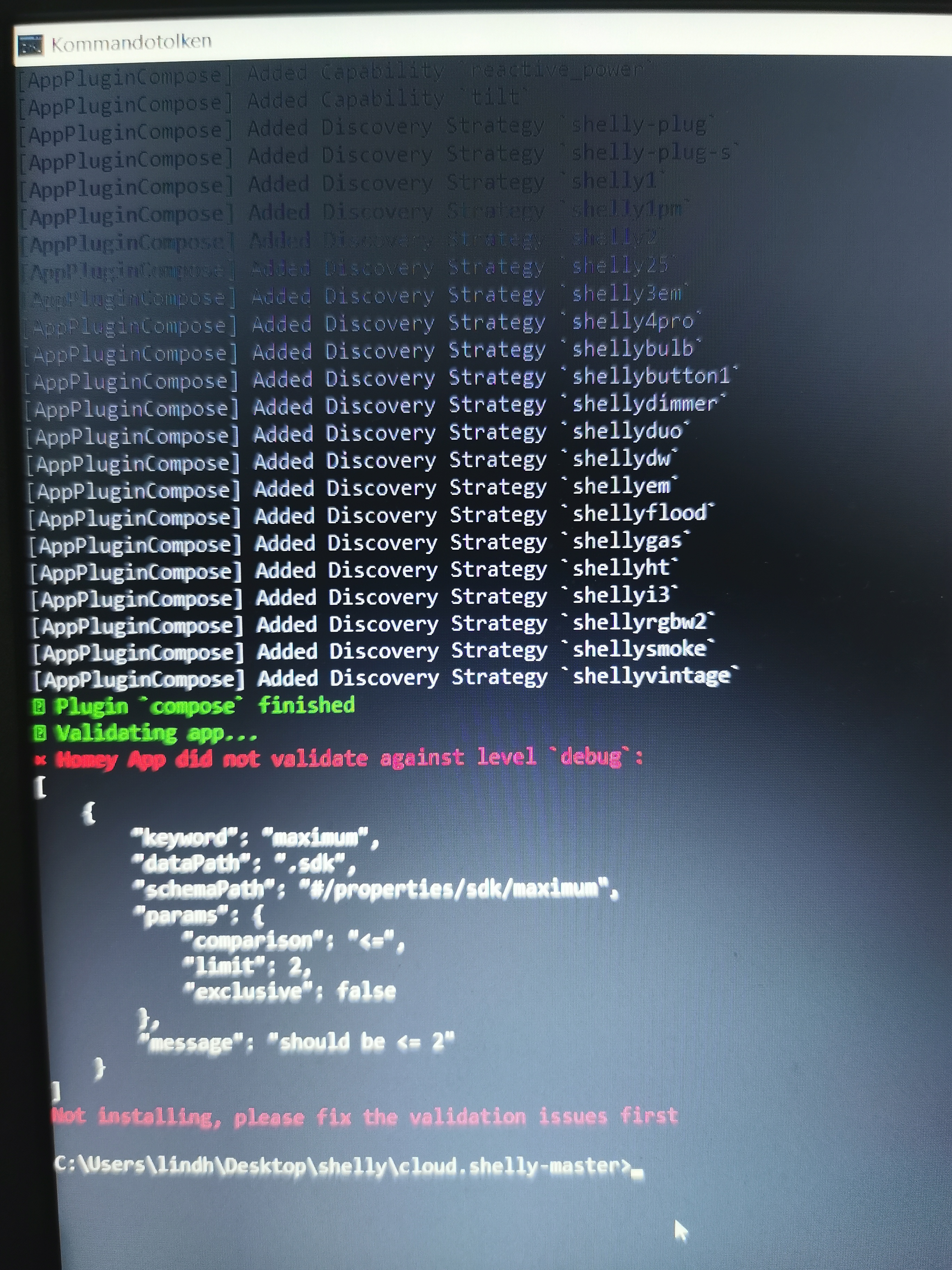

Here is the error:
× Homey App did not validate against level debug:
“keyword”: “maximum”,
“dataPath”: “.sdk”,
“schemaPath”: “#/properties/sdk/maximum”,
“params”: {
“comparison”: “<=”,
“limit”: 2,
“exclusive”: false
“message”: “should be <= 2”
Not installing, please fix the validation issues first
You are using the wrong cli. You need to homey app run command. And perhaps even install the Homey CLI if you havent yet with npm install -g homey.
Still same error

what CLI version do you have installed? you can see this by typing
homey --version
in the command line, current/latest version is “2.6.1”, you might need to update:
Yes I was using the wrong version, an update fixed it :man_facepalming:t2:

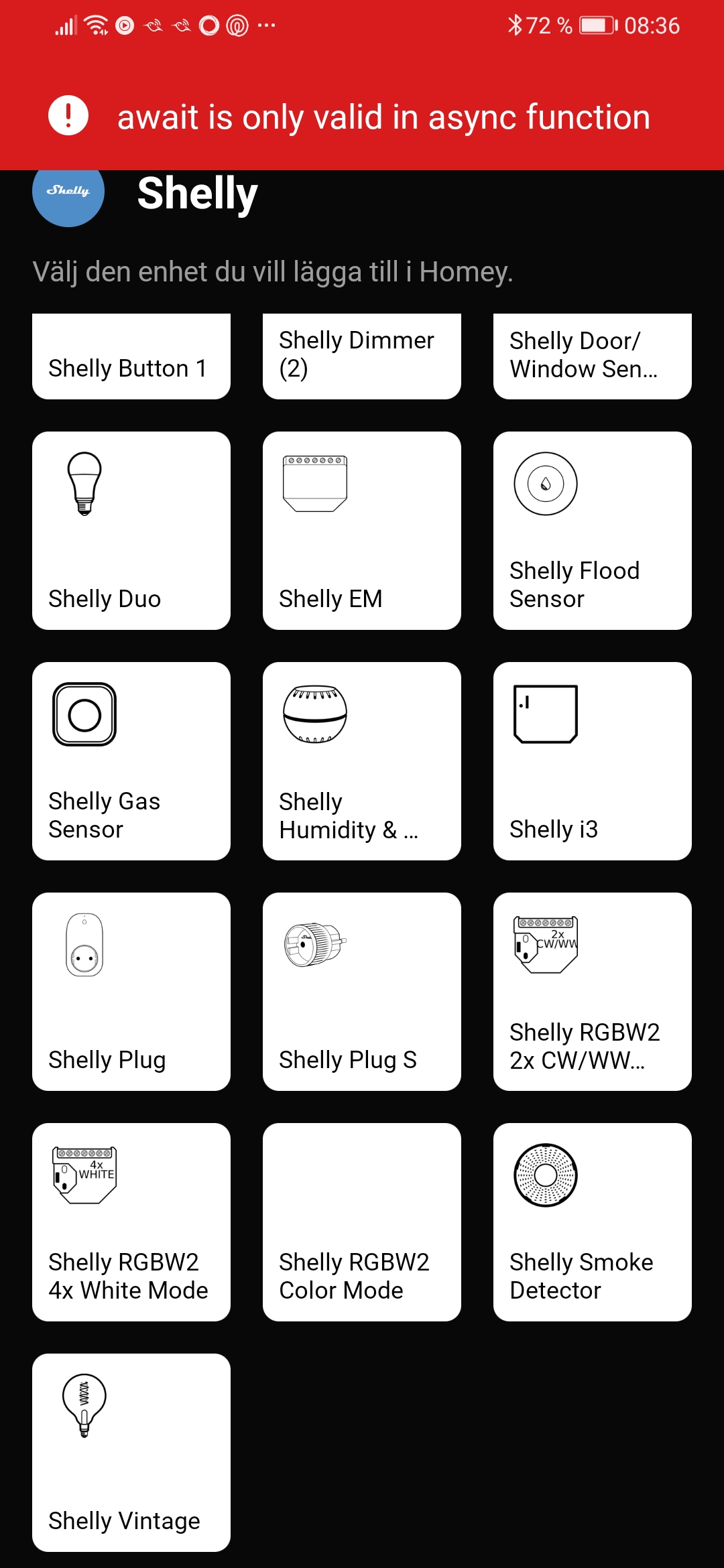

@Phuturist the didn’t work for me, I only get error messages when I try to control my rgbw2 and the app pauses.
I need to know the error messages to be able to fix anything.
One error when I try to control it and one error when I try to install a rgbw2 color
This when I try to install rgbw2 2x cw
Thanx. I fixed error 2 and 3 and pushed the changes to GitHub. Could you redownload and verify.
For error 1 it would be nice to see if there is extra debugging information on the command line. Did you use the homey app run command and did you see any information on the command line when trying to control your RGBW2 device?
