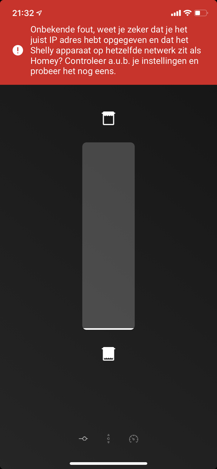

Hi
What is this problem the shutters do not move as you thouch on the app homey can you fix this problem?
Did you read the message and have confirmed that’s not the case?
hey do you mean?
Hey, your shelly has probably a different ip adres, something in Dutch what is writen in the red box?
:wink: so read whats inside the redbox :slight_smile:
Did you confirm the error message, is the ip still the same as entered in the advanced settings of the device
Yes but it is only in dutch if the homey is in dutch.
all ip addresses are fixed
And we have 49 Shelly’s but is wrong only shutters
To be fair, that doesn’t answer the question, right?
no sorry my english is not so good I sometimes make a mess of it, yes homey is in dutch also the reports
And the reports Is dutch
But we have the problem and its fixed,its the correction On the shutters position
Can you explain what fixed it. Did you mess with the newly added configuration which messed things up or did you have to change something to get it working again?
