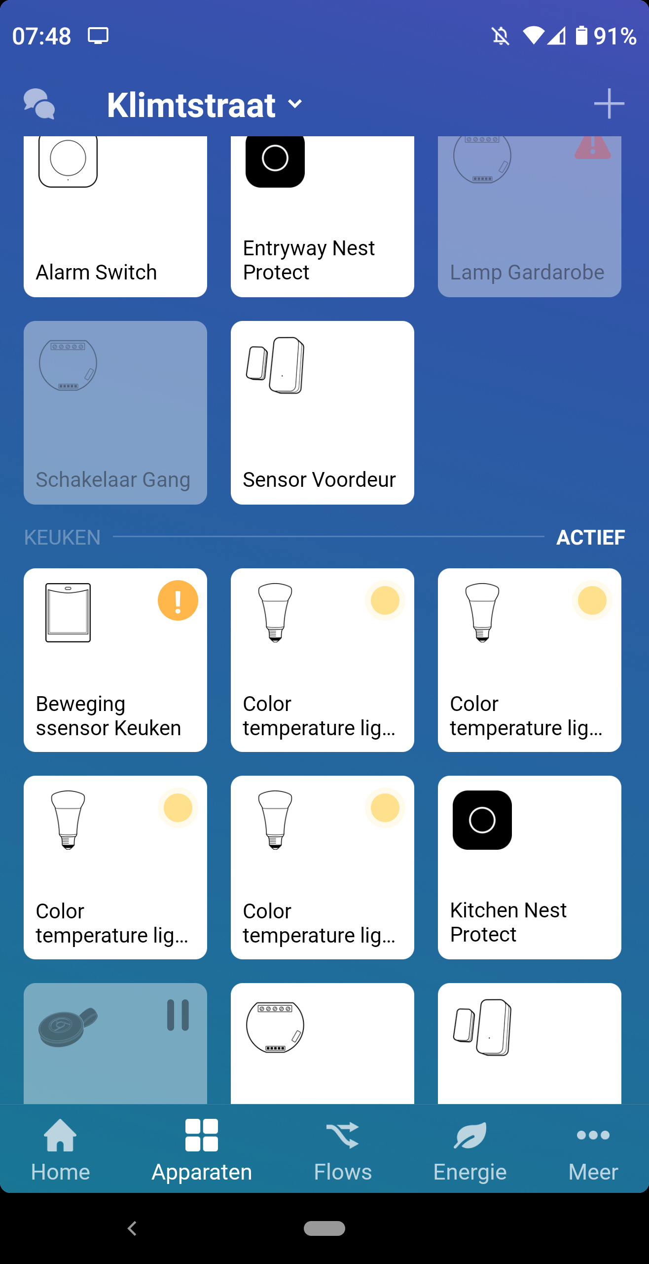

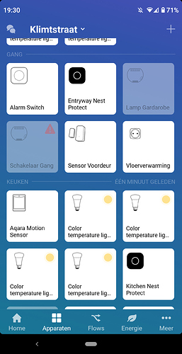

I keep the random isseus that some or all Shelly1 devices are not found anymore by homey. They have a static IP and the wifi coverage is excellent. This is withholding me for buying more devices. They are always reachable by the native Shelly app.
