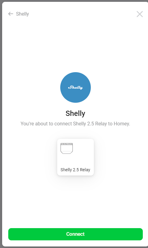

I’m trying to add a new controller, I choose SHELLY:
I then choose the type of controllers
In the next window I need to find all my controllers and select what I want to add
After I click on the link I get the error message

You are already adding the device to Homey Cloud. You called it Homey Bridge but it’s actually Homey Cloud. :wink:
Anyway, can you try and pair the copy the link from the pairing wizard and open it in a seperate tab in your browser. Does the same error appear there?
