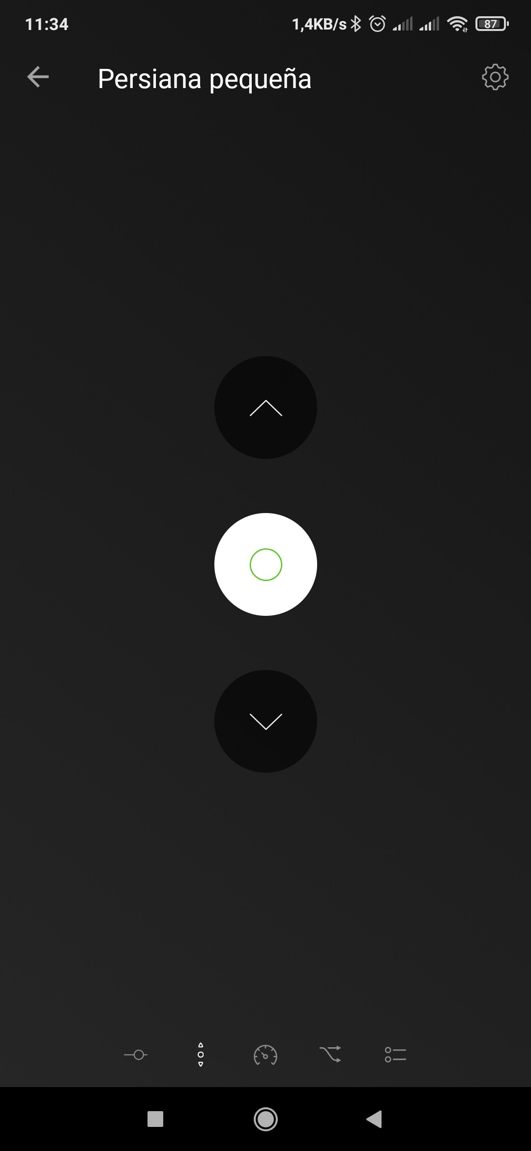

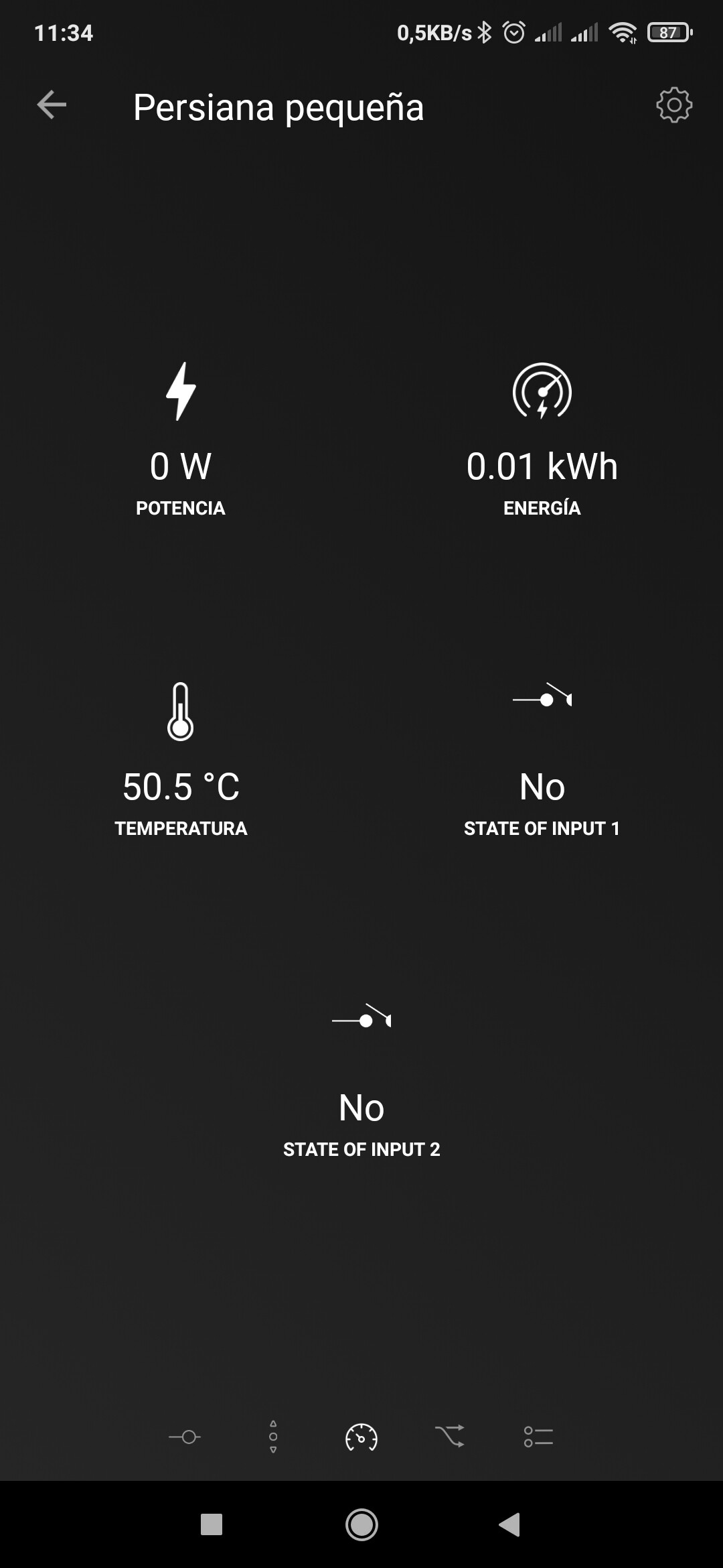

Can someone show me the interface in homey of a Shelly 2.5 with roller shutters please.
Thank you.

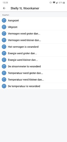

Do I need to re-add my Shelly 1L devices for the firmware check flow to show? Because right now I don’t see them anywhere.
I’ll solve that in a next release.
Restart the app, wait one minute, trigger the flow that generates the 404 error and send me a diagnostics report afterwards. Not sure if that tells me anything though.
Dont think so, should be available under the device condition and action flowcards.

Hmm, restarted the app as well but they aren’t showing, see screenshot below of trigger card:
