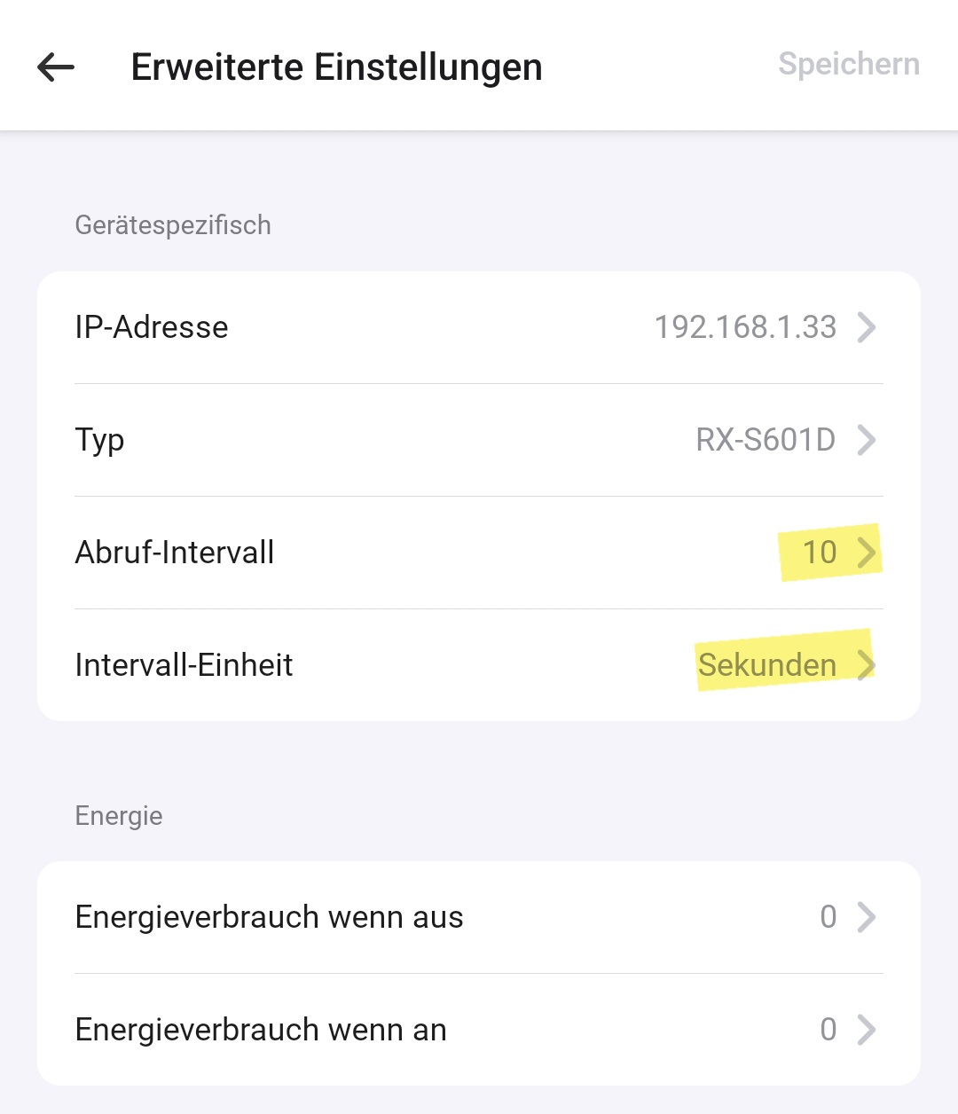

As workaround you can adjust the request period in device setting.
The old app used a fixed interval with 5 or 10 seconds.

The app can only poll data from the receiver. Push messaging is not supported.
To not overload Homey if instant data is not needed, the app has a low pull frequency as default. If I remember right 1min.
You can adjust it to your needs (5sec or 2sec) to get inshant feedback in device settings.
thx Ronny, I changed the pull fre. to 10 sec, the HP23 dosen´t seem to be affected at all in regards to CPU perfomance, everything os working great now with the 10 sec i feel

If yes, have you already adjusted the poll interval in device settings for your Homey device?
When you only control the device from Homey, it’s updating the state directly (reading current state from real device)
But if you change something directly at your Yamaha (via IR remote), the state is only synced after the set defined poll interval (60sec as default).
Can you please adjust this interval to 2 or 3 seconds? Then your Homey device should sync much faster.
