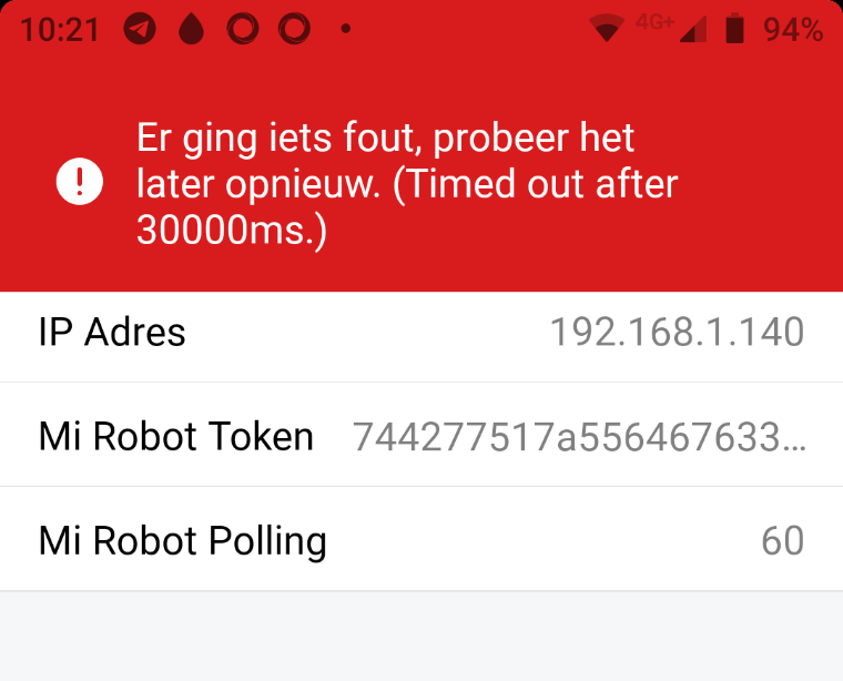

My vacuum cleaner is giving some issues with Homey. I added it successfully and the flows I made ran for a couple of days. But no it has stopped working.
In the App I see the icon of the cleaner, but it goes from ‘lit’ to ‘unlit’. What does that mean?
If I check the settings page, I frequently get a timeout.
The robot works fine with the Xiaomi Mi App.
What could be wrong?
I have been noticing issues myself lately. It seems the latest firmware for the Mi robot did something wrong. I still need to investigate it but it could be Xiaomi is adding extra measures to prevent people controlling their devices outside the official app. Probably not much I can do about it.
