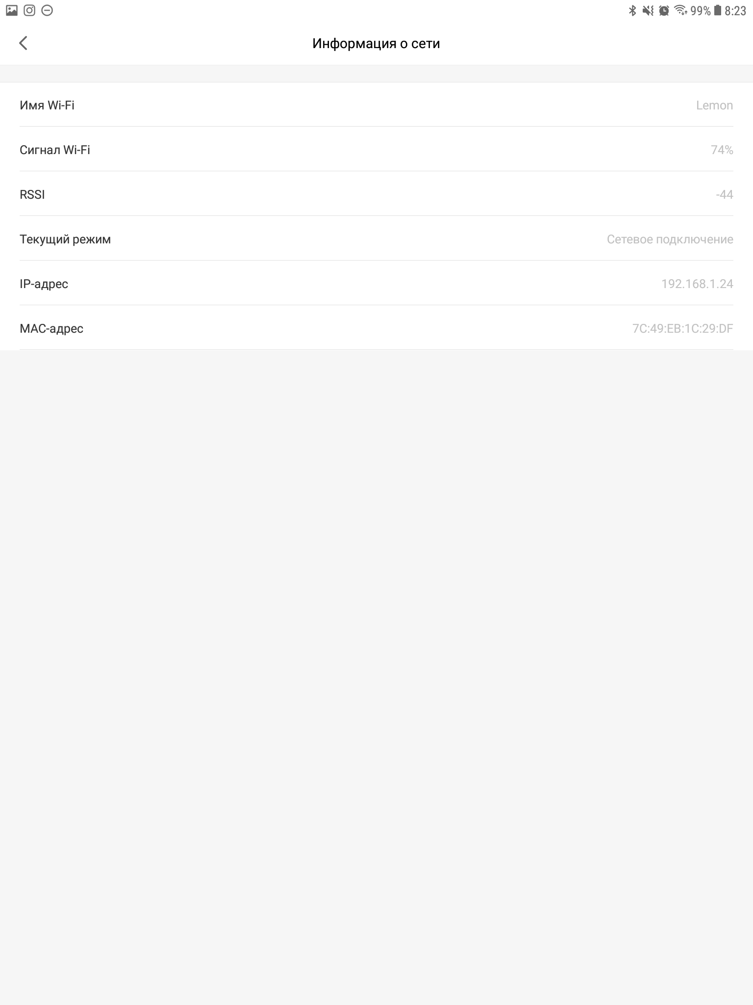

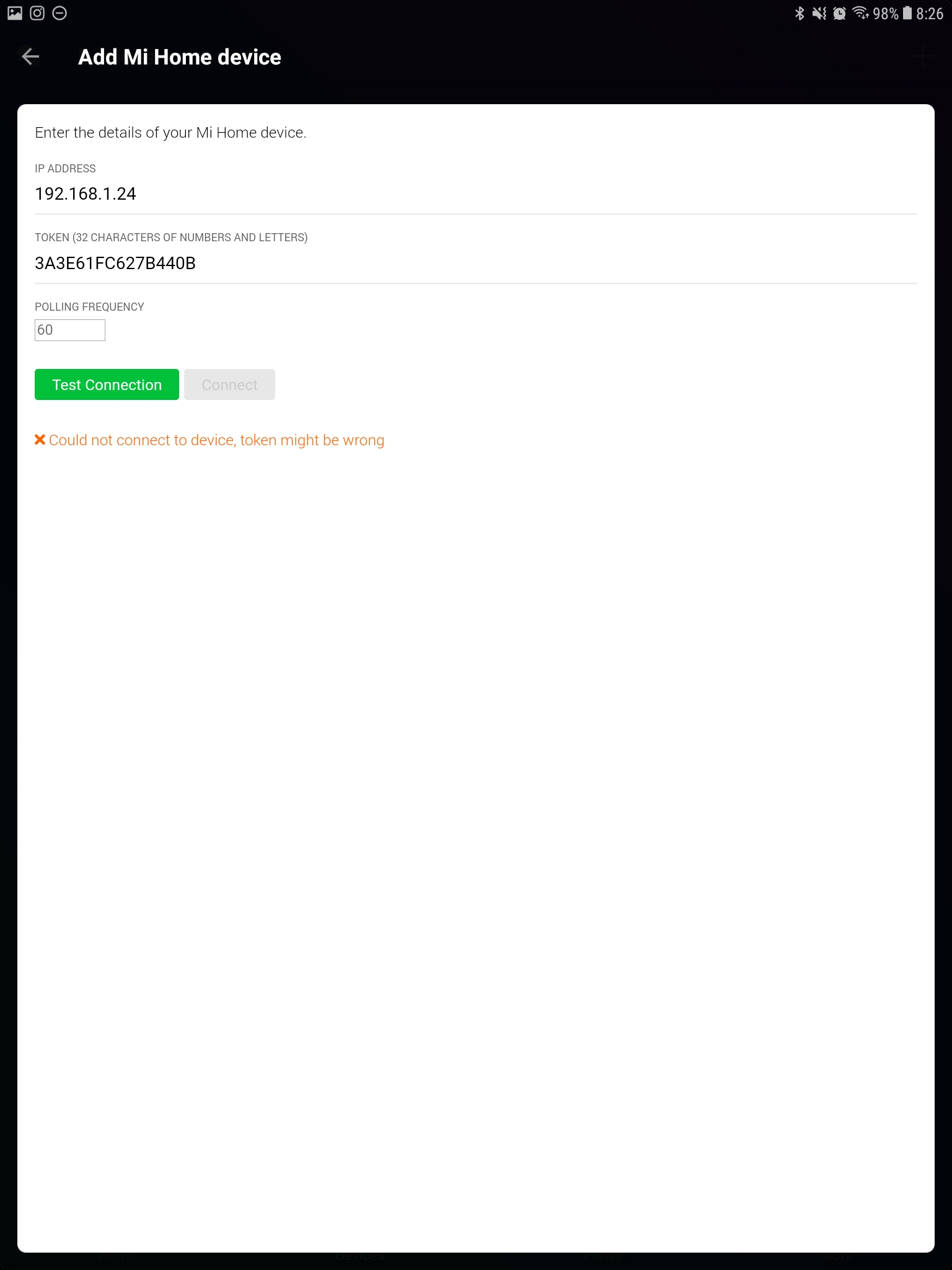

hi, something wrong with connection between homey and gateway, I can prove it with screenshoots:
(homey and mi gw are connected to the same wifi, homey has static local ip 192.168.1.20, mi gw - 192.168.1.24)
You are using the password instead of the token. The token is shown on screenshot 2. Use that and it will work. If you followed the instructions I send you would already have this working.
oh, thanks a lot, now it works :slight_smile:

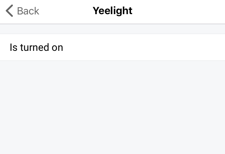

could you please add to yeelight bulbs check status not only by on/off but by dim(brightness) level as well? It’s possible to get this info from bulb as I know.
Depending on the type of bulb and it’s capabilities this is already implemented in the app. If you have added a bulb that has these capabilities but they are not shown under the device card (even after swyping left and right) please let me know which bulb you have.
mmm, yep, you are right but I mean yeelight card has it on “flow device adding” screen, please see attached screenshot (xiaomi rgb yeelight bulb)
This is default Homey functionally. You can use the logica condition cards and check the values which are available as tokens
