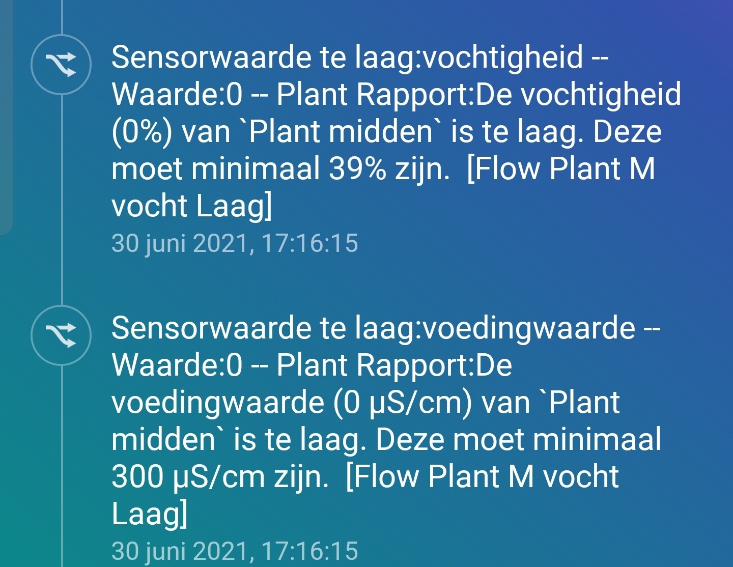

I can relate to the fact of an other level below the threshold (the fertility in my case) is also being reported while using AND “humidity is not the right amount” card.
I cannot relate to the fact it reports about a level above the definded threshold. That does not occur with the used flow here. Tested to set the upper threshold to 35%, while the humidity is 48%, and then forced the app to read the sensors
Flow (translated):
IF sensor value is below the defined threshold
AND The plant has not the right amount of humidity
THEN Notification with the local tags [Sensor] [Value] [Report]
Plant info:
(vochtigheid = humidity; voeding = fertility)
The same flow reports about both humidity and fertility, after I pulled the sensor out of the soil:

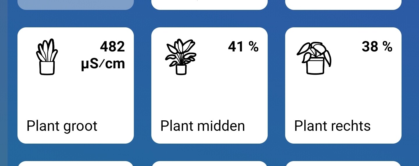

Can you add the moisture value to the tile? It now only has the temperature and lightlevels but the main info I want is the moisture and that’s missing…
I think that’s because they are custom capabilities. I’ll have to find out if that’s possible.
I’ve added it as an request:
Thanks!
In the video that Athom made about this update you can see it’s possible for a plant sensor to show the moisture value.
https://youtu.be/pizba-RpJeY
That’s based on the gardena sensor.
