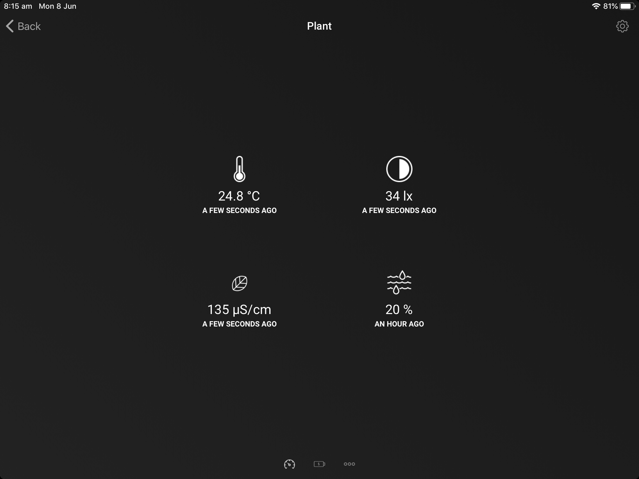

I live 17,000km away from Athom’s office and the only plant sensor I own reports correctly the values and triggers the flows that remind us to water the plant.
Homey firmware 4.2.0.
1st screenshot
2nd screenshot 1.15h later.
Perhaps I am just lucky, for a change :crazy_face:
