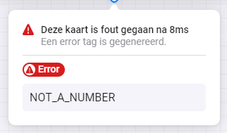

Hi Martijn,
tried to send a message to a whatsapp group:
+316xxxxxx / https://chat.whatsapp.com/ “linkcode”
+316xxxxxx / “linkcode”
But both don’t work? What’s wrong? I can send an ordinary message.
Get following error code:
HI @Ruud_Boegheim
Don’t send them both, it’s your number OR the group link.
:+1: Thanks for the quick response, that does the job!
