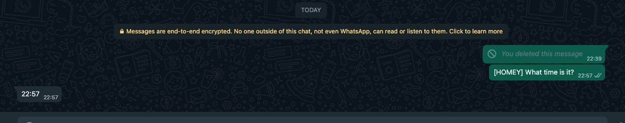

@Flyto sneak peak :wink:
damn, so excited, cant wait! is it on experimental already? :wink:
@Flyto almost, working on reply codes. So that Homey can reply to you in a Group etc :smiley:
So for example you and Homey whatsapp are in the same group you can create a conversation with Homey :sweat_smile:
In short, you can create a chatbot:

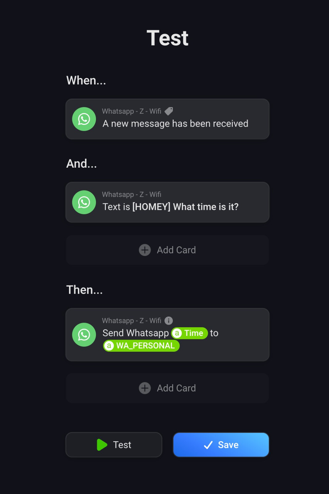

The “Receive messages” automation doesn’t work with “messages from self” ?
@Valentin_Ciopei it should. Can you check the device settings of your WhatsApp device in Homey?
Damn, so cool! I know what I’ll be doing tomorrow :joy:
Amazing! I will give this a shoot :pray:
I have it checked. I wanted to send myself a message and act on it. Like this:
LE: it works after I restarted the app. :slight_smile:

I think a flow card “Text includes (…) or (…) or (…) or (…)” to give different options within flow card for the same outcome, maybe 3? 4? Having new flowcharts quickly makes the flow very extensive :smiley:
You can already do this with Logic app. You can get the text value from Whatspp and search for whatever you like in it and take actions.
