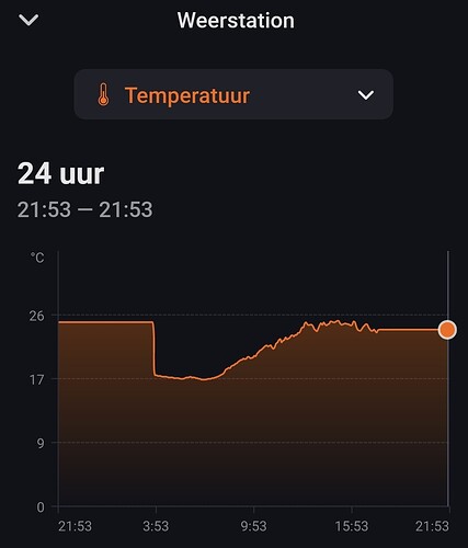

I have to restart this app every 4 hours in order to receive the weather parameters continously. I work with your latest test version 4.0.2
A flow in Homey Pro 2023 handles this restart, but it should be nicer if I can delete this flow …
I have no idea from that what the problem is. I have the app running for weeks with no issues.
What actually stops?
Can you send a log when it does stop?
I removed the automatic restart flow this morning, as I was at home all day.
No strange behaviour: the outside temperature (the only parameter I use) was received in good order all day. Edit: also the 2nd day without hickups.
I had several disconnects for Homey itself for the last couple of weeks. More times a day I got the message that Homey Pro lost connection. After consulting Athom support I got some help from Arno (very fast response, within 20 minutes the first!!!). Most of the recommendations I had already in place but I hadn’t tried to use the 5GHz band for Homey.
After I moved Homey Pro to this band some days ago no more disconnects. And no issues with receiving Weather Undergroud data anymore as it now looks like. The internet connction was shaky…, maybe due to a crowded 2.4GHz band…
As soon as I have a hold in receiving temperature data from WU I will create a log and send you.
