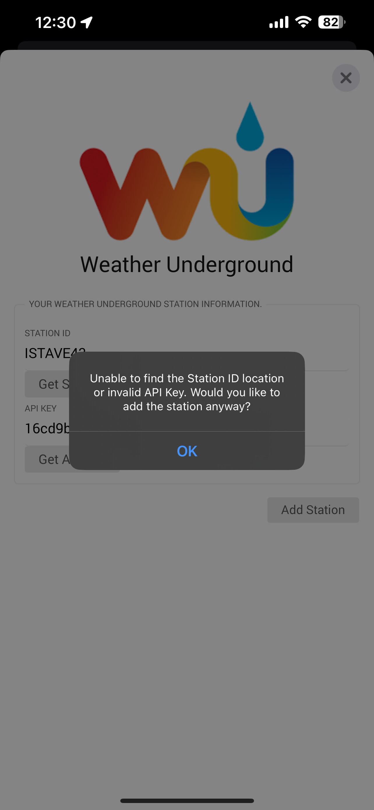

When I add my weather station (Vevor 7-in-1 WiFi/YT60234) I do get an error claiming that the Station ID or API is invalid. Both are correct, and I have even tried re-generate the API key. Same result. I tried installing the 3.1.13 test version, same issue. The log in this version misses newline so it appears as “one liner”. The device is added and pulling data correct.
When trying to add the forecast, same error but device is not added.

Normally when creating keys they become active within a few minutes, but it can take up to 24 hours. So all I can suggest is to wait for a while to see if that helps.
I did wait 24H before I wrote this message. Had the same issue yesterday when I first configured and tested the weather station. Since I still had the samme issue, trying to add a forecast device today, I tried delete yesterdays API key and renew with a new one today. If possible, try to create a forecast device and see if the same happens at your end?
It’s working fine for me. I just added a weather forecast to one of my other Homeys.
It might be some lag on wunderground side, I’m not able to search for my Station ID (ISTAVE43). It was created yesterday. So that might be the reason of the error message.
You can use my station Id with you key if you want to check the key works. The station ids are public, so you can use any of them with your key.
