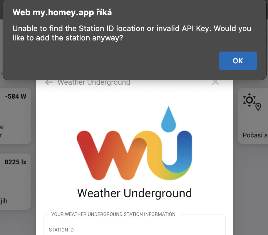

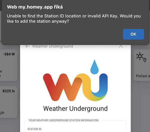

Hi, I would like to add station and forecast as a devices, but I only managed to add station.
But when I try to add forecast with same station ID and API key I am getting this error:
and when click ok, nothing happens :frowning:
Any ideas?
That is very strange. Have you tried to restart the app or reboot Homey to see if that fixes it?

Both didnt work… have this in log:
2024-01-05T20:08:22.176Z
2024-01-05T20:08:22.762Z
  • retrieve data
2024-01-05T20:08:22.766Z
  • Done retrieval of data
2024-01-05T20:08:22.767Z
  • HTTPS Error: 404
I just tried to add another station, I did get the same error.
I renewed my API on the website, the old one has expired.
Now it is working again.
Also my password has to be renewed.
App is working like before.
:+1:t2:
I tried to add forecast for different station in neighborhood with same API key and worked fine :smiley:
That is really strange, but I’m glad it’s working.

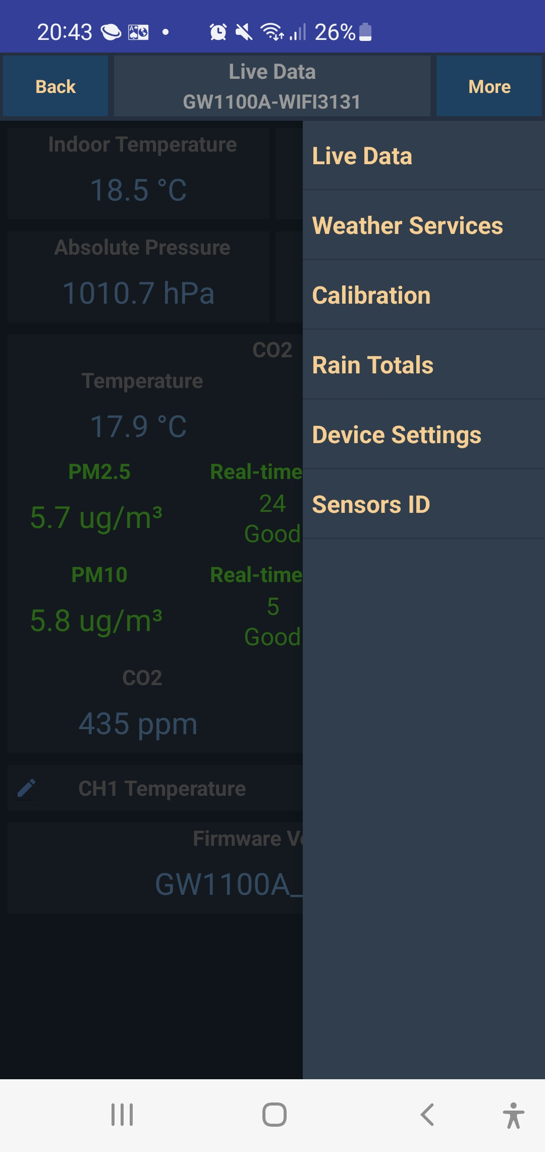

Hi Adrian,
I have a gateway 1100 but cannot connect it with the Homey app, it seems that I have to make a set-up but I cannot enter the settings
What options are on the left side menu?
This is what I see in the ws view app

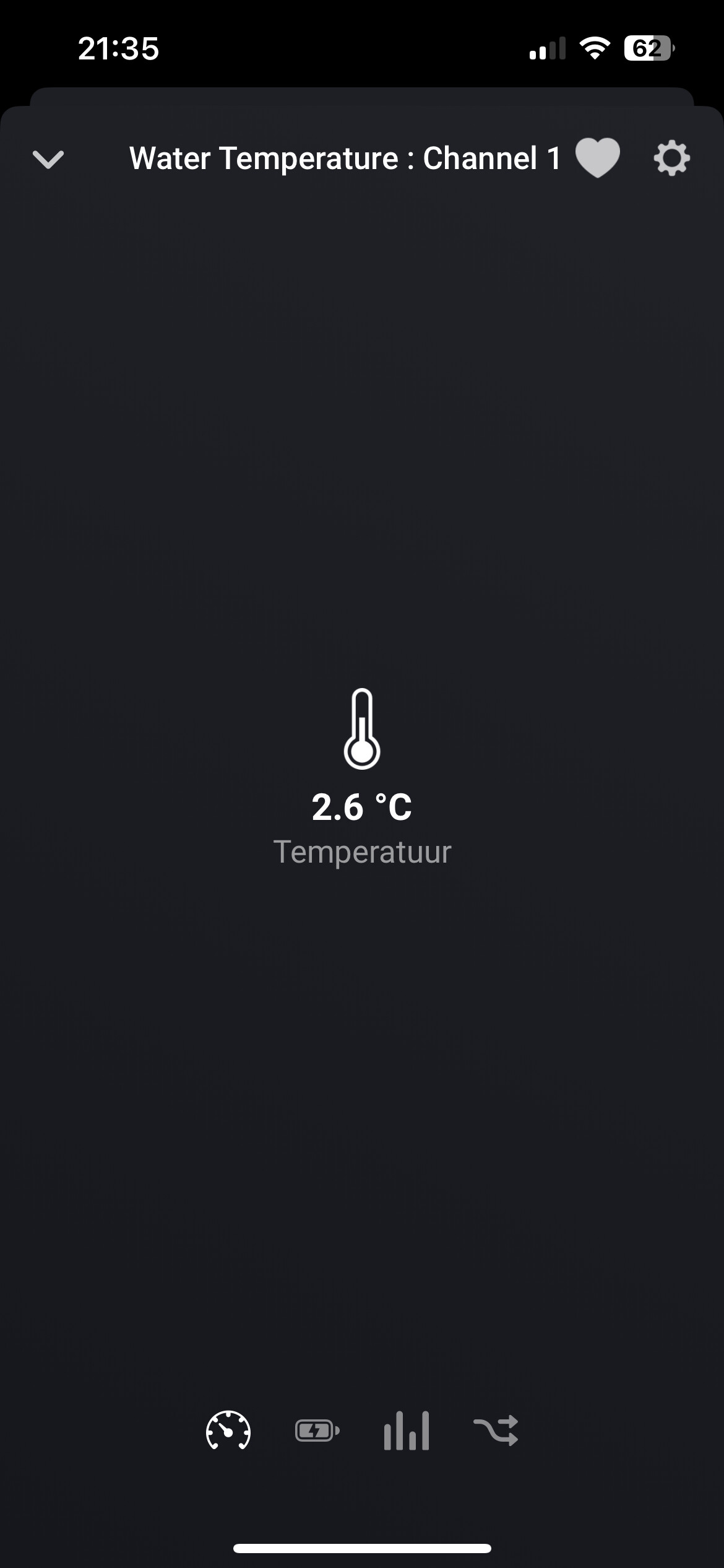

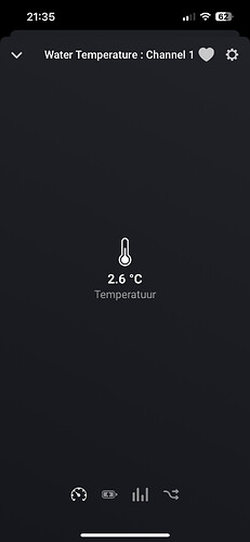

Thanks for the quick respons, after a re install it works perfect
Except the cold water :sweat_drops:
Can you “fix” that :laughing:
I wish I could :slight_smile:
