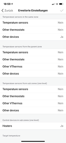

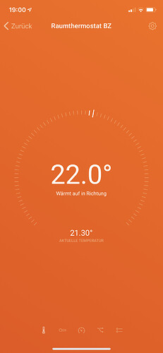

imthis are my settings:
The device seems to be heating, but the shelly switch is off?
thanks
philipp
hello,
i found the problem, the thermostat was off, i didn‘t understand the meaning of switching thermostat on or off, now it‘s a little bit clearer.
