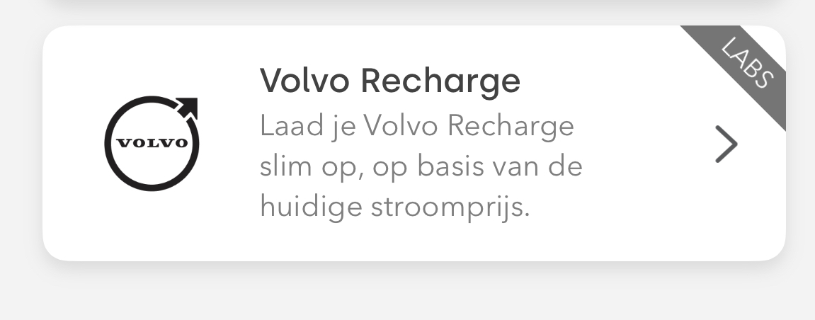

Tibber released an API for the 2022> Volvo Cars.
Link? I dont see it in my Tibber app. Still says they dont support cars with android auto.

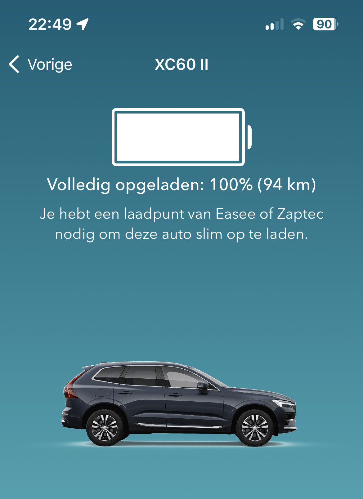

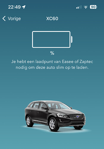

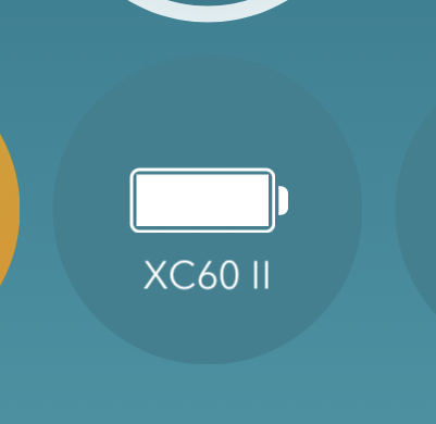

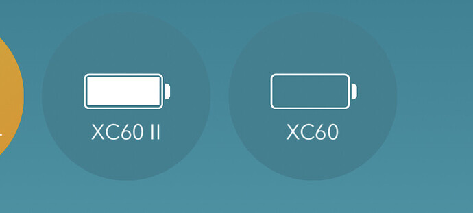

It finds my XC60 2022 Recharge and also my old XC60 D4 2015 no battery so it says empty.
Ok, I turned on Labs and can see it as well.
Seem to be using the API @Ronald_Doelen linked to earlier - since only thing Tibber do in this powerup is show the battery state of charge. And of course, use the SoC when you have a connected charger like Easee or Zaptec.
