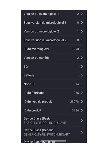

Hello
I’m new Homey Pro user especially for my switch Vitrum.
But I try to associate my BS II On/Off and it doesn’t works. The switch is include like a z-wave piece non reconize. Thanks for yopur help
Thierry,
Add it as a normal Zwave Device and send me the screenshots of your settings panel.
I need those infos:
Vendor ID
Product Type ID
Product ID
Every Vitrum Device has a different ID. I’ll ad it to the app so you will be able to include it.
Looking forward to it.
Oreste
Hi Oreste
thanks you for your help.
Vendor ID : 266
Product type ID : 28978
Product ID : 3924
Thanks
Thierry
this test version includes your IDs
Please Try IT and report here if everything works
Once I get your feedback, i’ll publish a new Official Release
