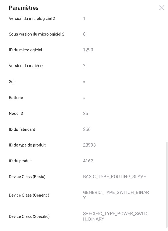

Hi Oreste,
it seems with the latest App this product is not being recognized: 01E06H062
PRODUCT TYPE ID: 0x7115
PRODUCT ID: 0x1016
I am getting this.
Here is a new test version:
Please confirm it works so i’ll publish a new stable version on the repository.

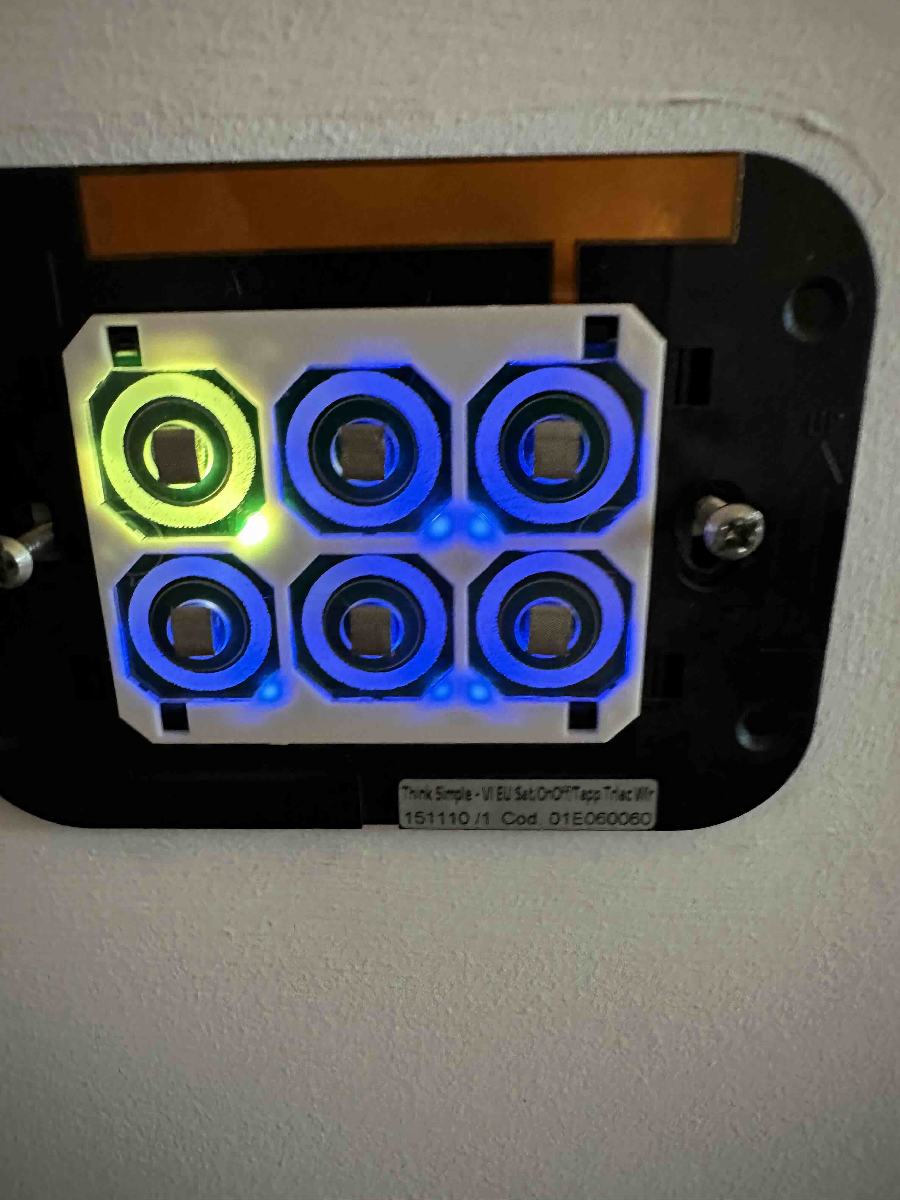

could you please add support for this device? This is a Vitrum VI Triac version.
Many thanks
Alexus, i added mentioned IDs. New version will be deployed soon and it will contain your ids. Please use Vitrum VI when adding device.

Hi, I can’t pair the VITRUM SATELLITE EU with ONE BUTTOM and VITRUM ON/OFF with 6 BUTTOM
Gianluca, please pair every device as a generic Zwave and give me Product IDs and Product Type IDs. I’ll add them to the app.
I just updated the app with those new IDs.
