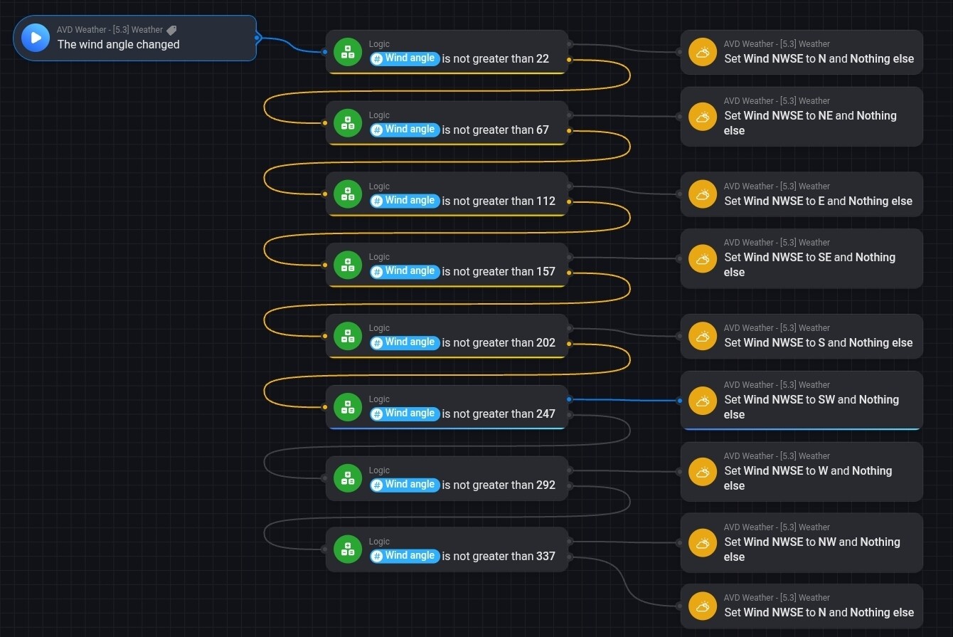

Is it possible to change the anemometer value, currently in degrees, to put it in cardinal point? Or add cardinal point in the card?
Thanks :slight_smile:
Please see the Advanced Virtual Devices from the Device Capabilities app to fully customise the Device.
I’m sure Arie can do this with one BLL expression, but here’s my way to create cardinal points from degrees;
just add a text field to an Advanced virtual device, and feed it via flow cards:
