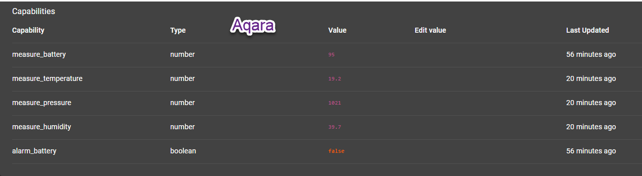

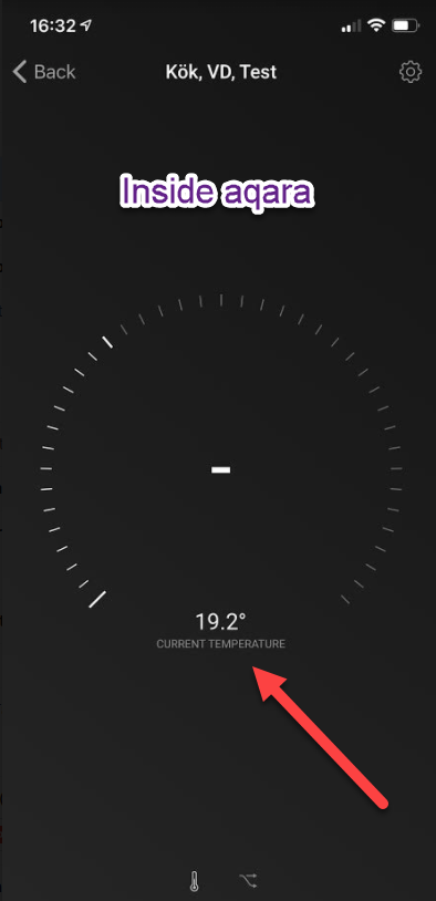

Its hard to explain, I can get the flow to work, with measure_temperature with an aqara temp. sensor, but I dont get a tile on the thermostat showing the temperature.
If I look at the aqara temp sensor and its capabilities, it dosent have target_temperature as an Capability only measure_temperature

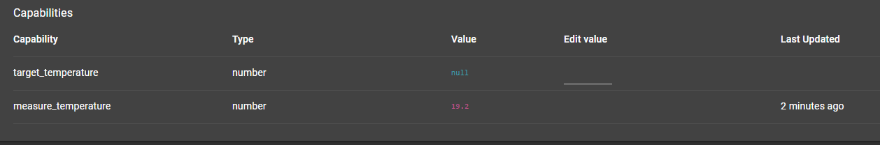

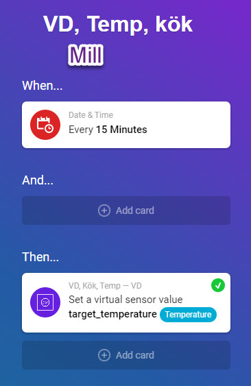

If I use another sensor from Mill, its for my radiators, its has both capabilities measure_temperature and target_temperature, and then i can make flow target_temperature and it workd and i get a Tile on the thermostat
hard to believe.
please, enter in developer a value for target-temperature (VD) manually and check the tile.

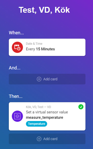

You have to trigger / start the flow by the Aqara sensor “when temperature has changed”
(and if you want to test, when asked, just enter a fake temperature between -100 and +200)
And you’ll have to round the output of the Aqara temp sensor to x.5 and x.0
Take a look, this works:

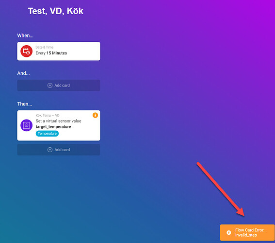

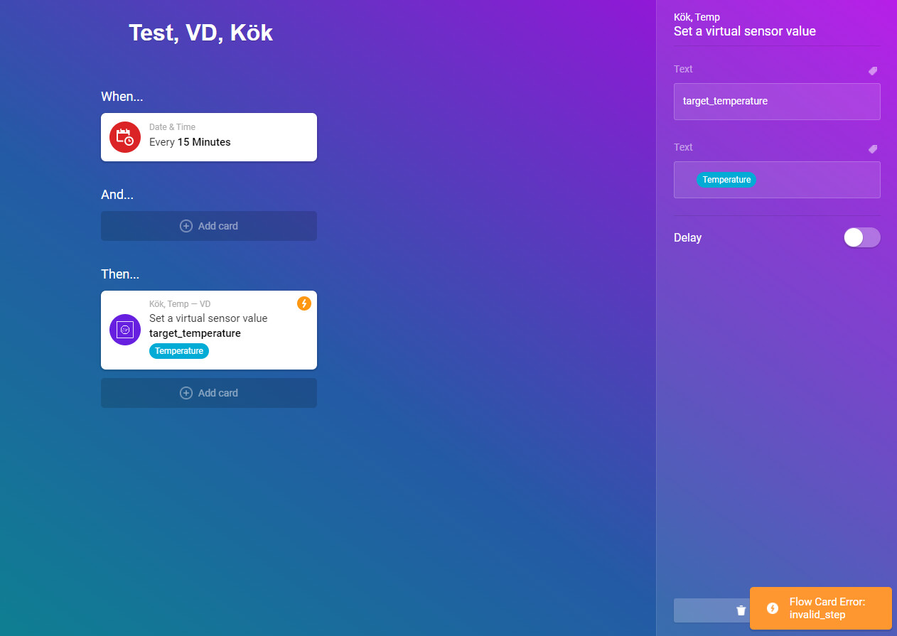

So I got it to work once, which is one step in the right direction, when i tried to get i to worked again I got Invalid step
@spajder_ua any value other than xx.0 or xx.5 will result in ‘Invalid Step’

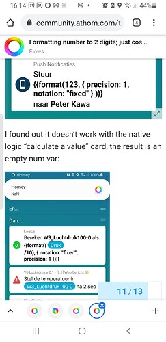

I’ve an issue with the format() function.
It seems to work ‘everywhere’, except for (Better)Logic ‘Calculate a value’ cards.
This function adds a .0 to numbers (I’d like 100,5 and 100,0 to be displayed, not 100,5 and 100)

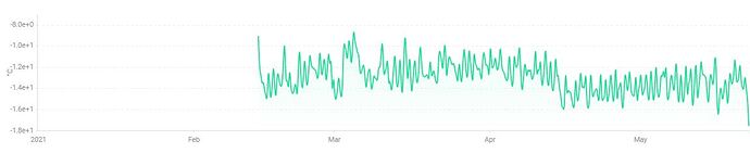

I have a ice cream box freezer, running with Aqara temp sensor too, without any seal running fine since Feb :grinning:. See below chart:
