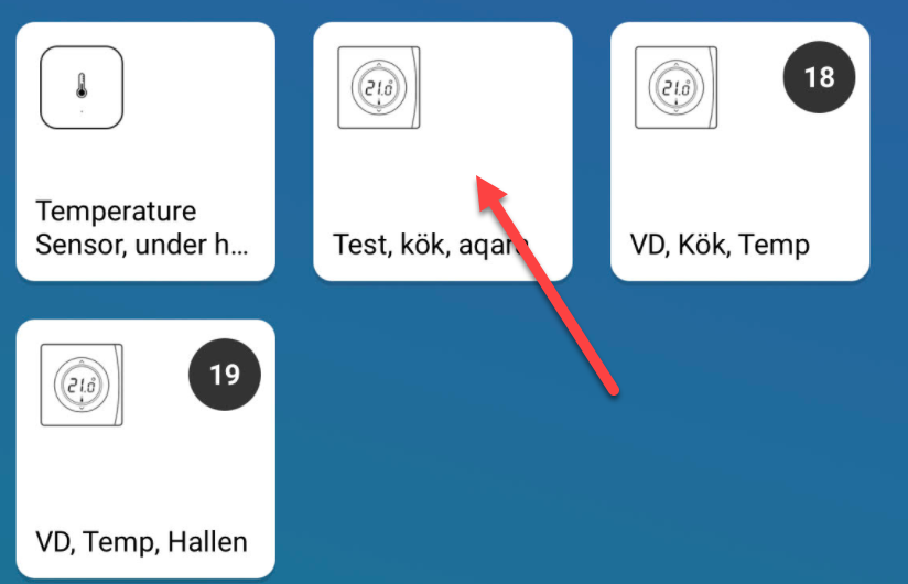

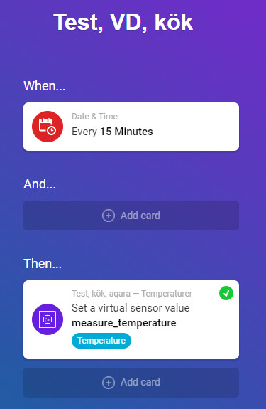

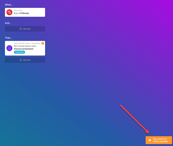

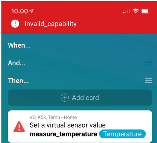

I cant add the temperature to a VD Thermostat with the measure_temperature from a aqara temp sensor.
I get invalid_capability when testing. The aqara sensor only has the measure_temperature Capability.
When I try the same with with a Mill sensor that has target_temperature capability, it works fine.

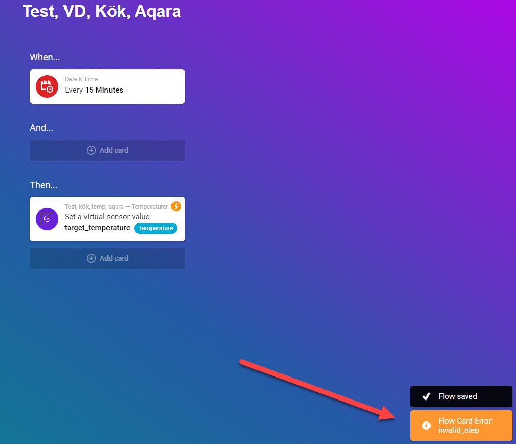

You’ll have to round the temperature to .5
(limitation of the virtual device).

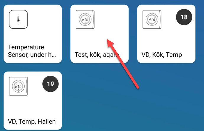

This will work on a with an aqara temp sensorn, but it will not display the temperature on the VD thermostat as if you use target_temperature with a sensor that has that Capability , but you will see the temperature if you go in on the thermostat device.
target_temperature is shown in a tile.
So you have to set target_temperatur instead of measure_temperature for the VD
Yes, but not all of the sensors have that Capability. Aqara temp sensor only have measure_temperature Capability.
I’m not sure if I understand your goal right. What I mean is you have to set the target_temperature (VD) = measured_temperature (aqara, Tag temperature) if you want to see the measured value of the aqara in a tile of a VD.

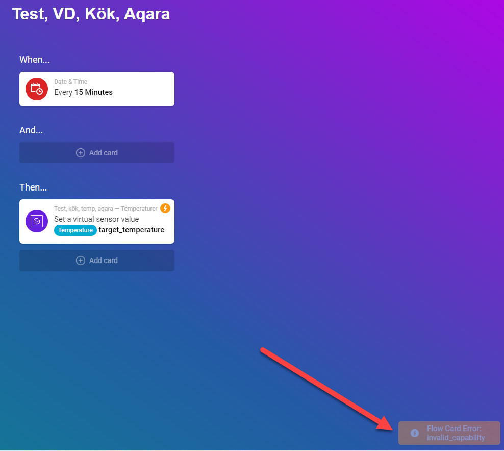

Ok, but as you se in my screens above, i have done that and its not showing up as a tile on the VD.

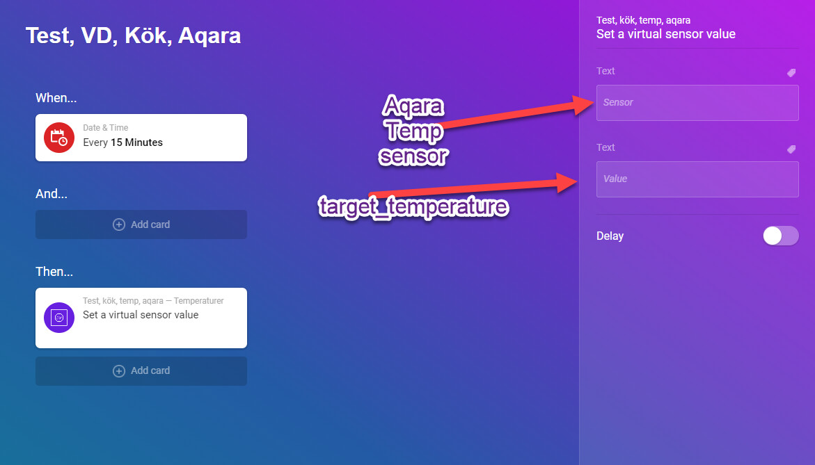

no I don’t see it, because you have to do this the other way around:
name your VD variable target_temperature NOT measure_temperature.
I assume that the tag=temperature belongs to the aqara sensor:
in my case “Aktuell” is the temperature value of a sensor.
That is not important, it is about the capability of the VD thermostat / thermometer.
The Aqara temp sensor just sends numbers, wich you can assign as temperature values.

show us the capabilities of your VD.
are you sure you had defined the capability target_temperature when you created the device?
