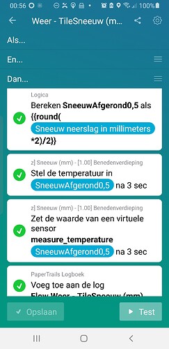

How 'bout setting a bogus value, like 123? A temp which in real life never can be reached?
And you have to round your input values to 0.5
F.i. like this

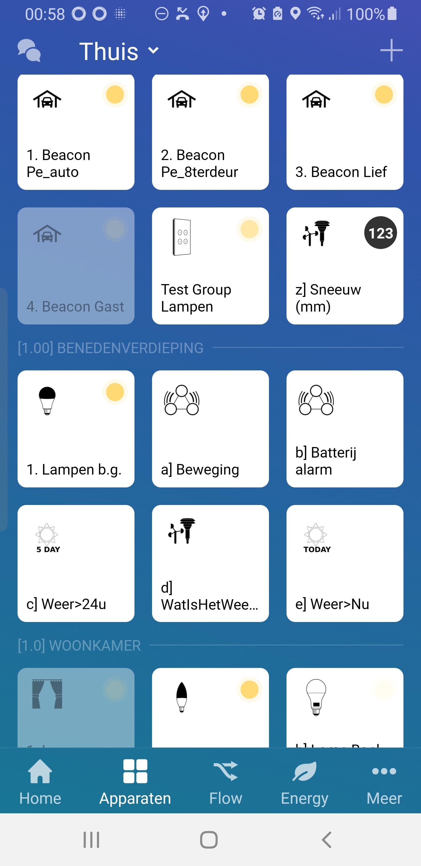

I forgot to tell you the virtual thermostat I created to show snowfall in mm, was set to a range from 0 to 200°
That’s why the "snow"tile can show 123 as a value.
