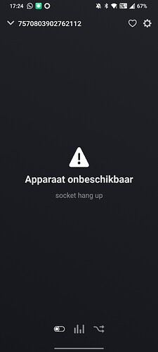

Over the weekend, I had this event happening.
Any idea what could be the trigger for this to happen?
I am currently on version 0.3.3 and a restart solved the issue.

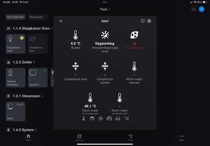

Hi Kenny,

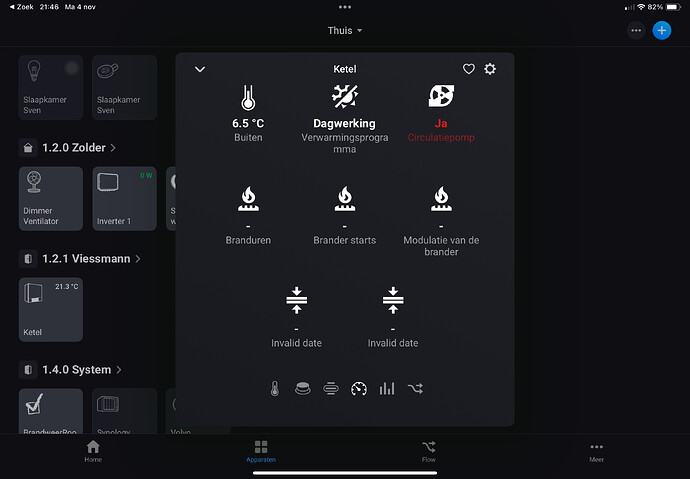

Great work again, I see it getting better and better, nice man. Something is wrong with the compressor data for me. Looks like an invalid date issue.
Maybe for your roadmap, the temperatures of the boiler would also be a nice addition. I think I have 3 values, bottom, top and main

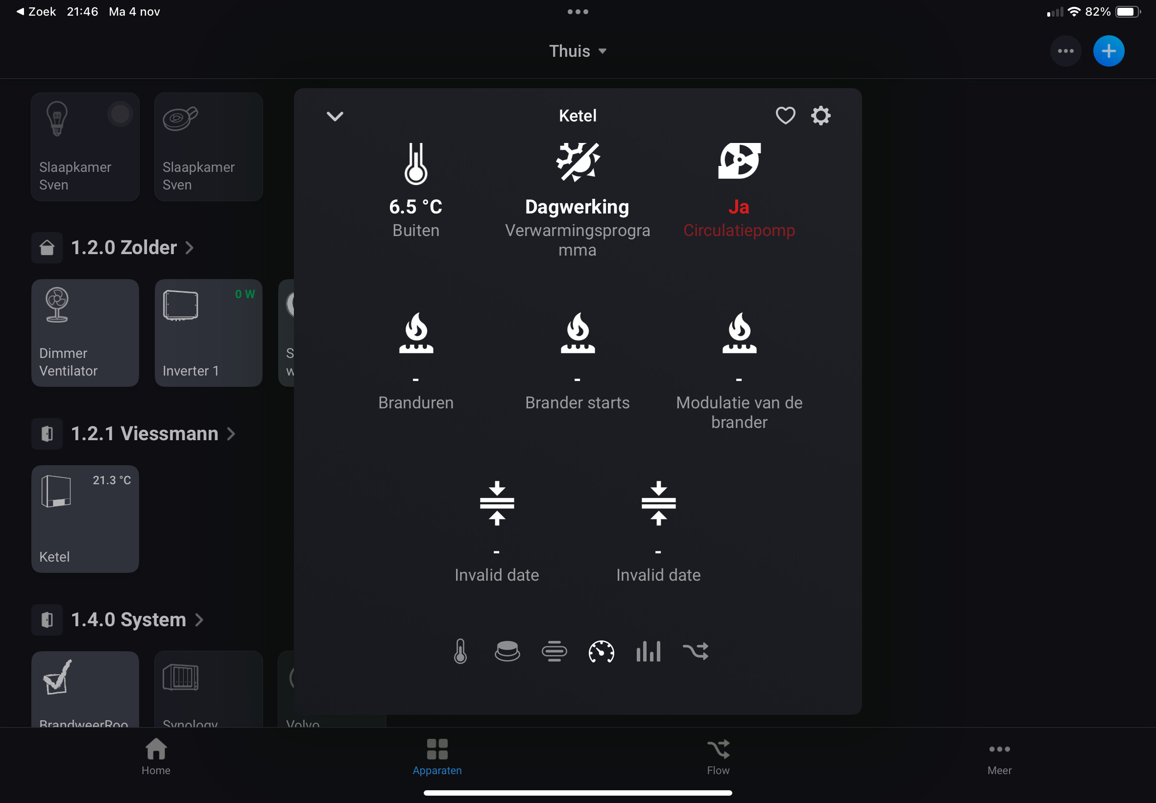

Hello, same issue.
Could you guys elaborate on that? Maybe a screen shot?
but of course, below screenshot. when item clicked you normally get the time in sec/hours/days of the last update. now the message of not valid date.

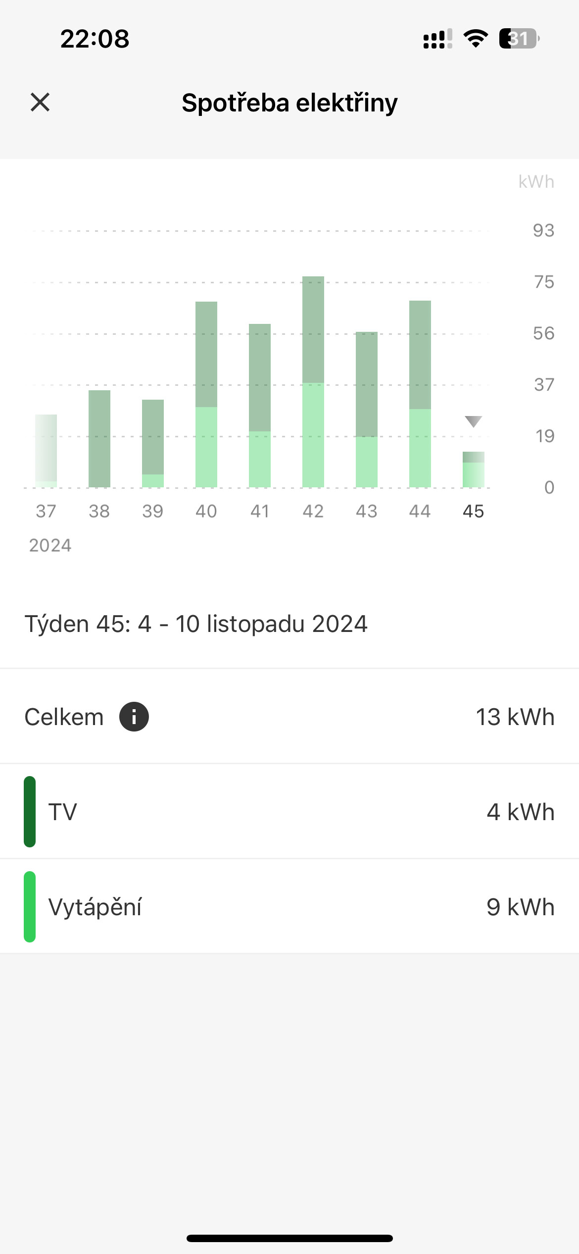

Yeah, I am also attaching screen where is visible that it shows that circulation pump runs for 2 days already which is not possible I guess. Also would it be possible to have there current temperature of hot water in boiler? It is quite weird that it seems to be impossible to add there power consumption, because original Viessmann app shows quite nice graphics where consumption is visible and even divided in to Hot water and heating.

I’ve pushed a new version (v0.6.0) which should fix the compressor statistics, and add more statistics in general. This version is now also published in the app store as a stable version, since I want to get as much as people people to use it and I do believe that we can now easily support all Vitodens and Vitocal devices, with the generic device support and the new authentication logic.
Related to the power consumption for VItocal devices, until now I cannot find it inside your features.json file, which indicates me that Viessmann hides it after some paying plan.

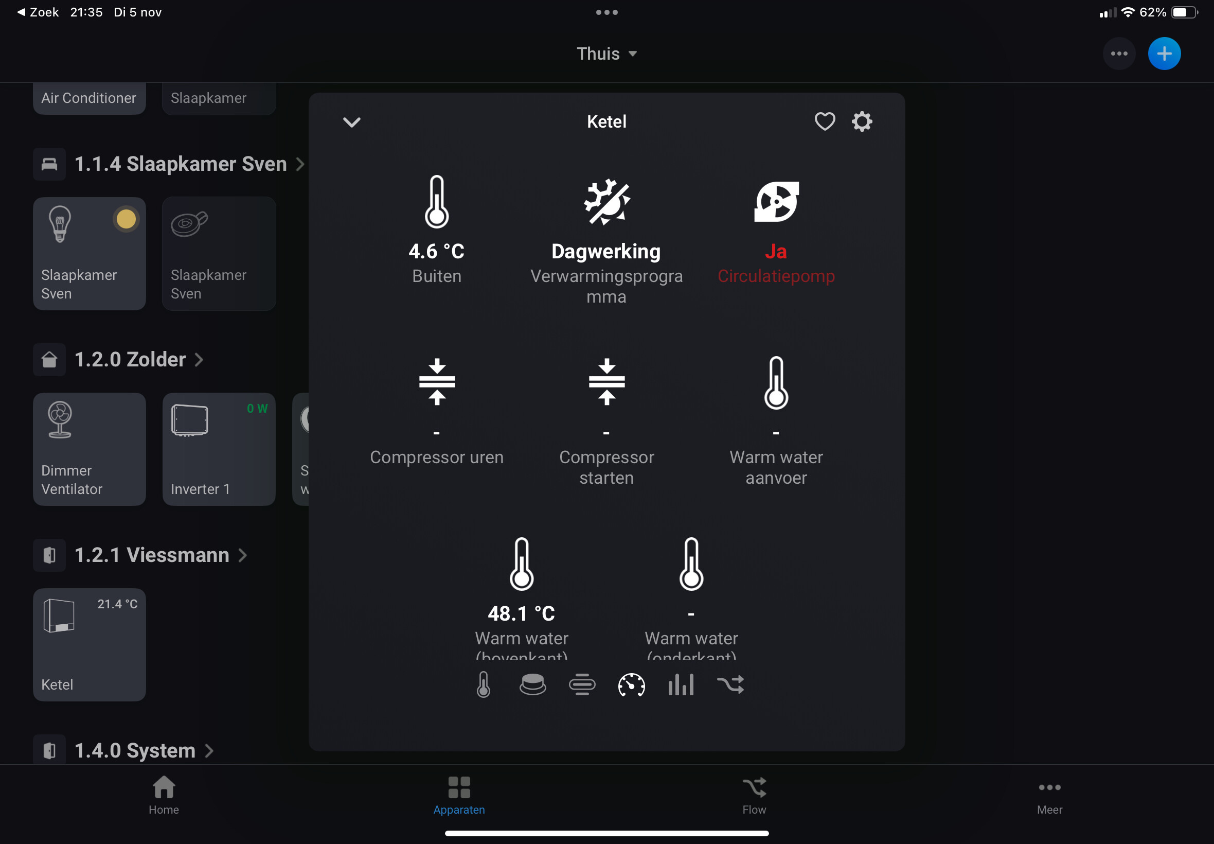

hi Kenny,
I still have no data on a few properties. always invalid date issue or so it seems. Below is a representation of this.
Exactly same issue and data not available.
Hey guys,
There was a typo in the compressor value name, I fixed that one in v0.6.1. This version is now published to test, and submitted for final approval too.
It can be that some metrics don’t appear on your side, some metrics are unavailable for certain devices. I’ll look if I can hide them in that case.

Compressor stats are working :muscle:t2:
yep, the compressor stats working now, only boiler temp (bottom and main) not working (invalid date). The boiler temp top works!

There is something off with the names of these variables. I guess the left one is for DHW?

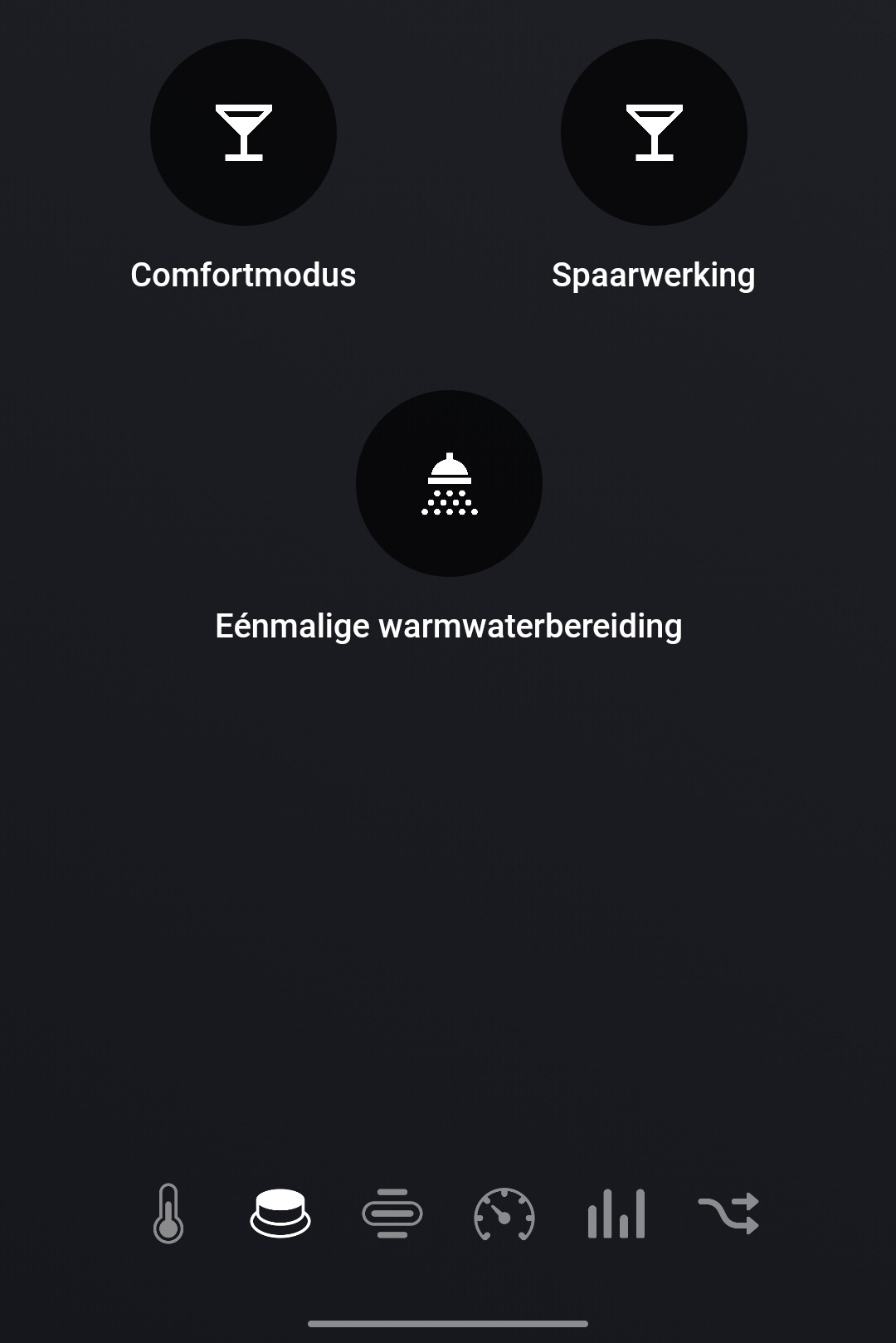

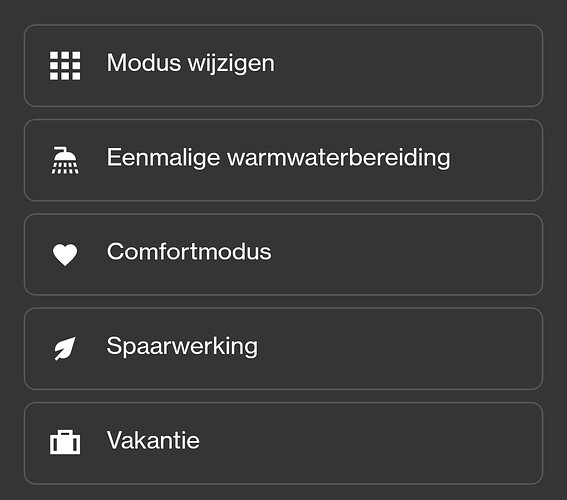

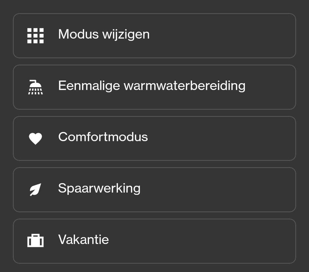

Maybe the eco-symbol could be replaced to better represent the function? Today, both symbols are the same.
