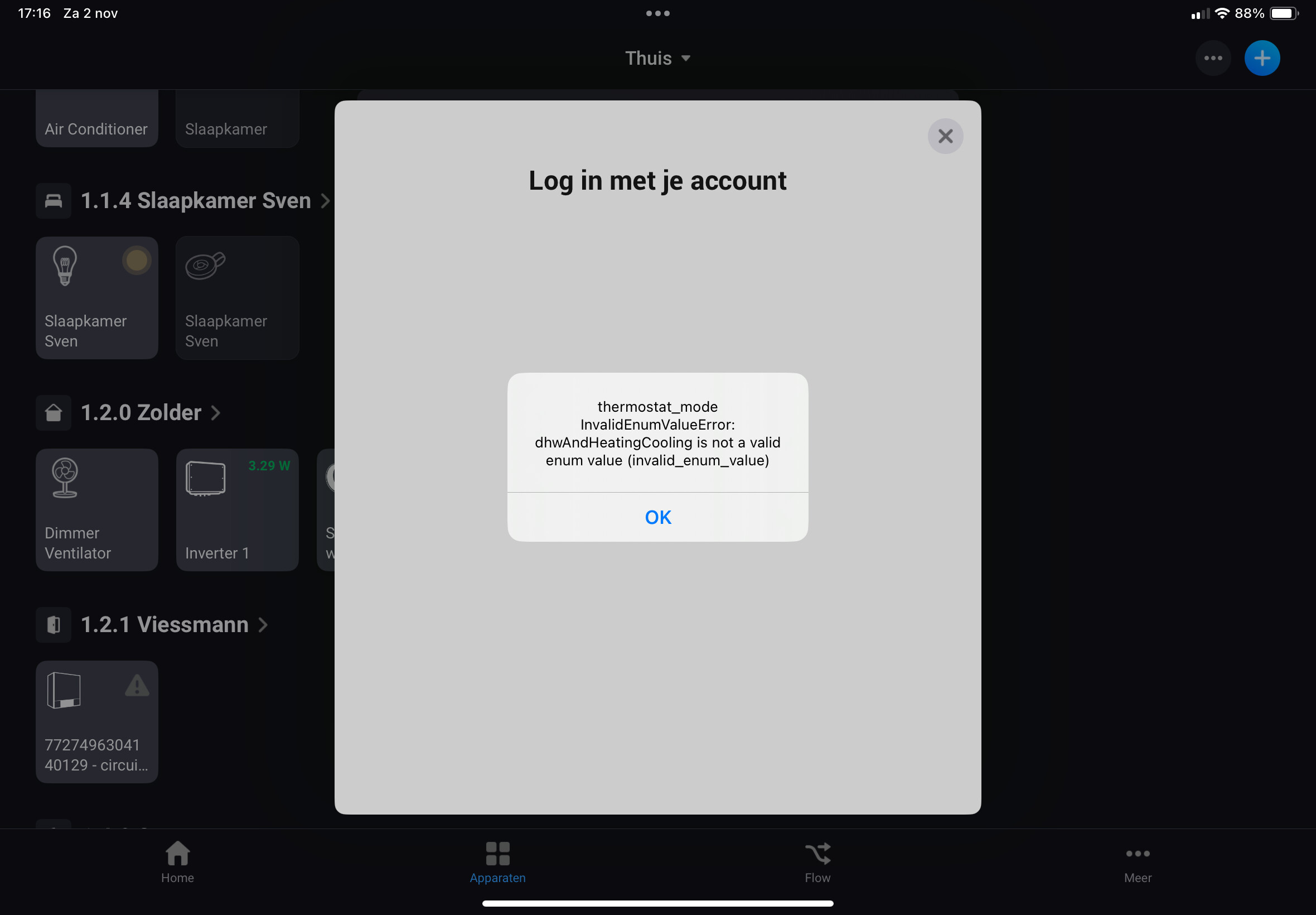

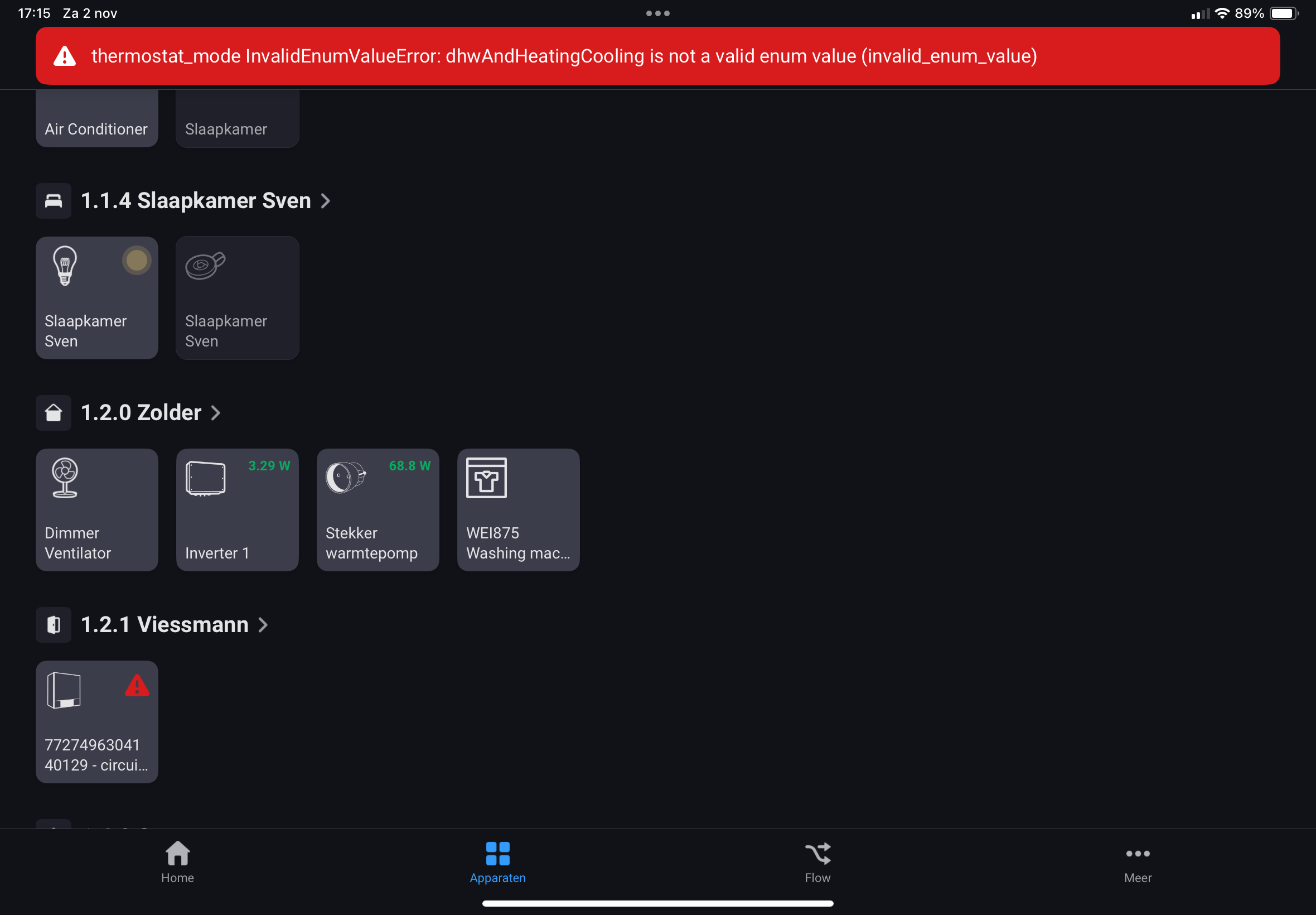

I have a Vitocal 200-s. But I cannot add vitocal device, I can add vitodens with out direct error. But when I want change the temp I get a error (the expression evaluted to a falsy value.) and I cannot see detail info of the hot water temp. I can also add vitocal with vitotronic 200 but directly with a error/warning about the thermostat_mode.

The issue with the thermostat mode was one that I expected. Another user reported the same. It serms some vitocal devices, despite beding the Same model, have different programs…
Thats why I added the generic vitocal in hope to fix it. It did not find Your device I understand? I will dig into that because it should find it.
