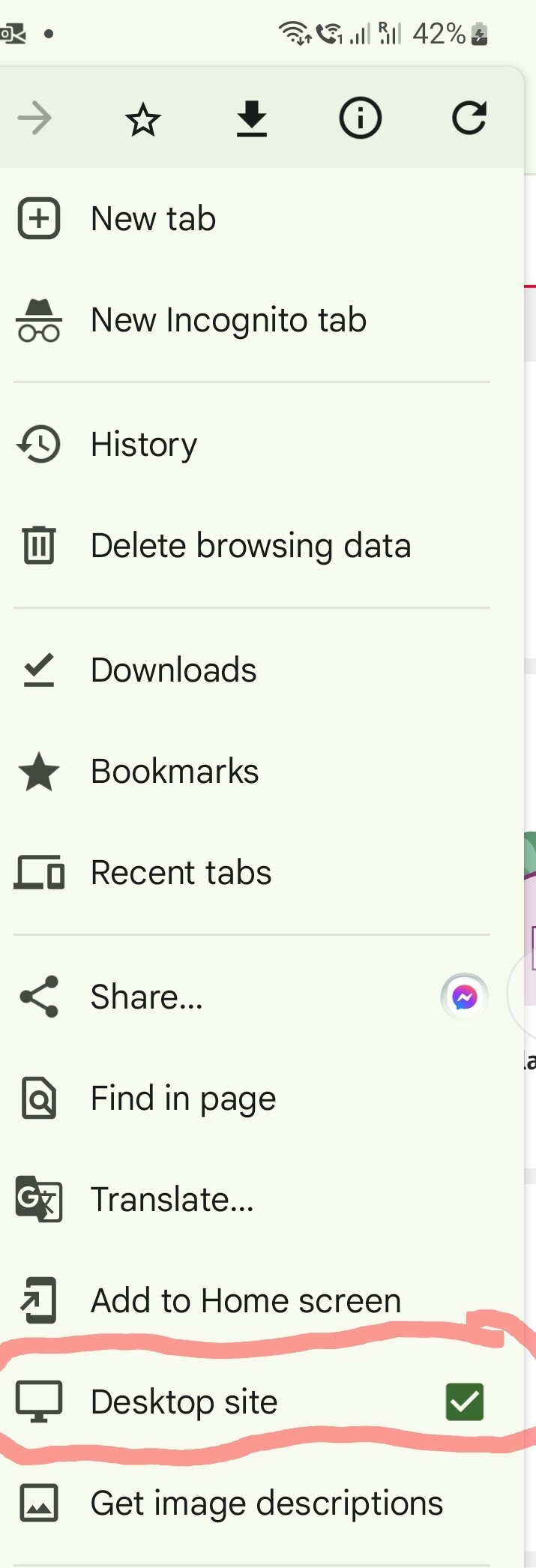

And you don’t need to use a PC - it’s fine to use Chrome on your mobile, with Page for computer activated. At least on Android.

I’ve taken some screenshots from my mobile. This is how it looks like in Android Chrome, when you have Deskop site enabled.
