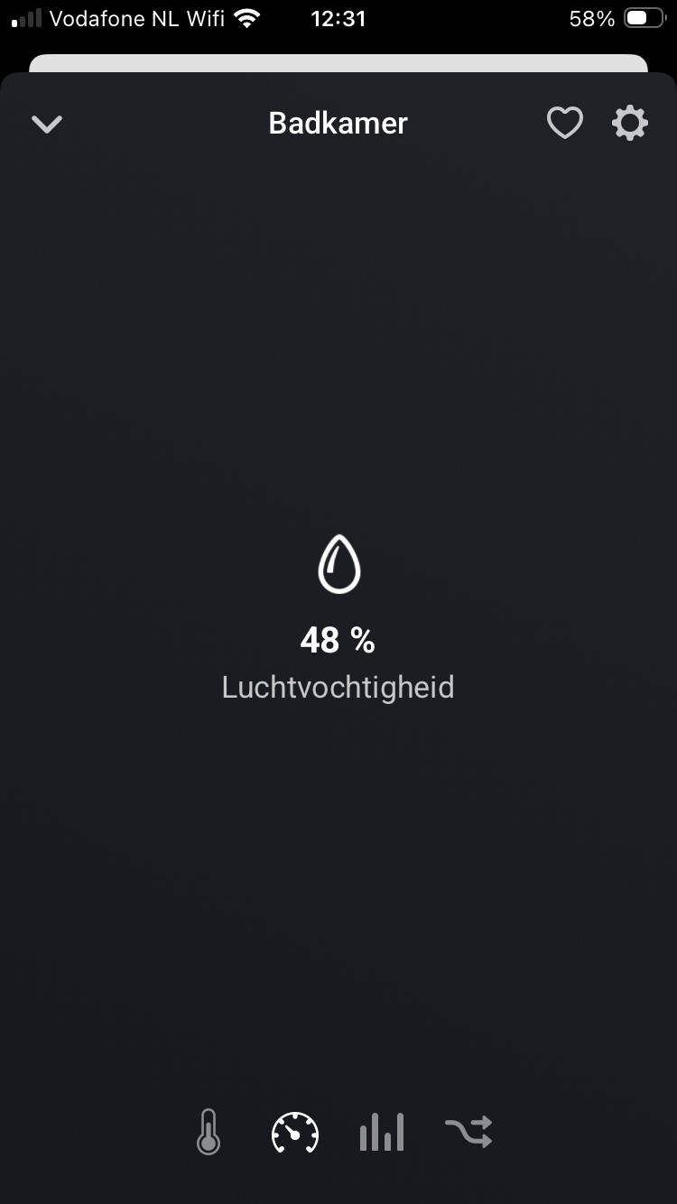

Thanks for your work! I installed an R-208 today and installed your Homey-app. It seems to be working fine. It would be nice if the RH-sensors in my thermostats would be readable in the app (so I could boost my ventilation when RV goes up). Could that be done?
Update:
I did some tweaking in your app Chris, and now I can see the hunidity from my thermostats and use it in flows. I’m not a programmer at all, so I may have made some stupid errors, but for me it works!
this whould be great, how did you add it?
Hi Michael. I tweeked Chris’s code by adding a capability for measuring humidity. Then I uploaded the tweeked code directly to my Homey via the command prompt (and set the app not to update…)
