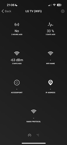

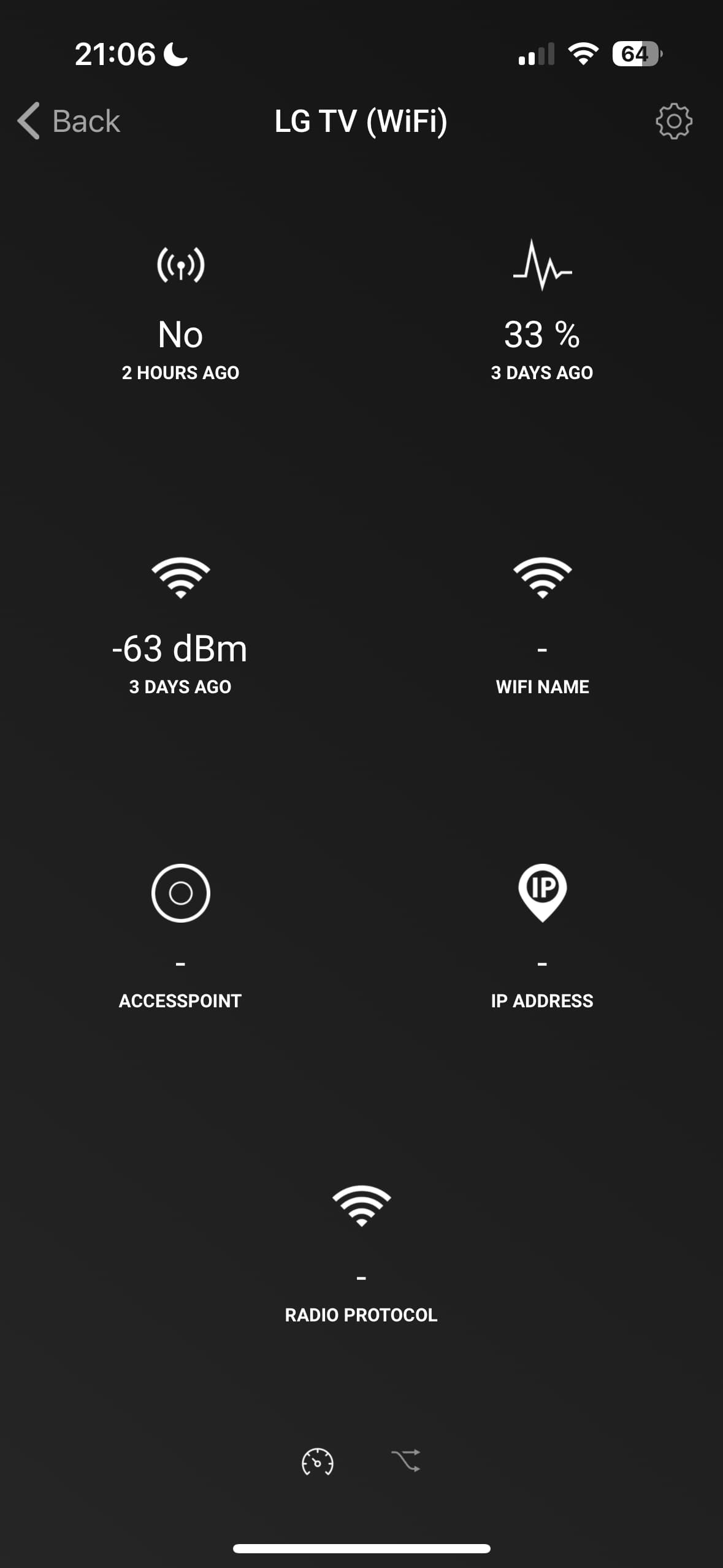

My tv connects to the network but trigger card does not work anymore. I’ve tried to delete and add It again, does not trigger flow, nor detailed info…

Please remove the devices and add them again.
Done. Pretty much same behavior. While fixing the flows the app stopped working.

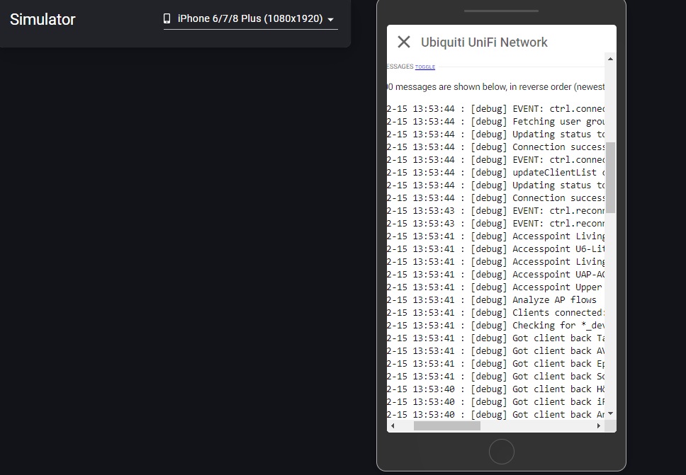

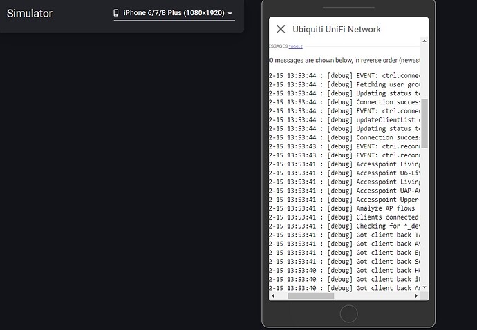

Hi, I have the same issue with a crashing app. I don’t know if this is of any help.

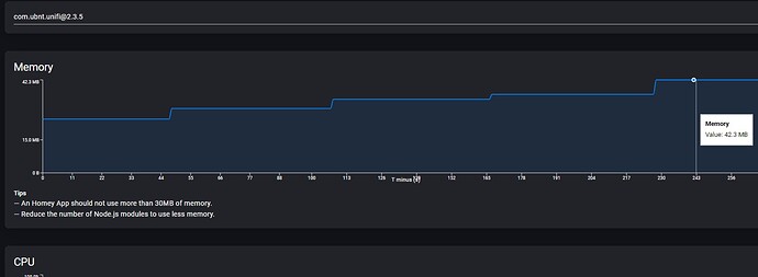

I took a screenshot from the App Performance tab: Memory allocation go from 16 MB to 50 MB within 10 min.
Toggle the debug setting: There’s a flood of messages. I thought it should only query the Unifi API every 15 s.
