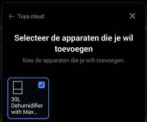

Next I tried to add the dehumidifier to Homey. Based on my understanding dehumidifiers are supported by default; the app has a dedicated driver for such devices. I select Add new device > Tuya Cloud > Dehumidifiers. The Tuya Cloud app shows a list of available devices. My dehumidifier is included:
After completing the new device wizard, the device is added:

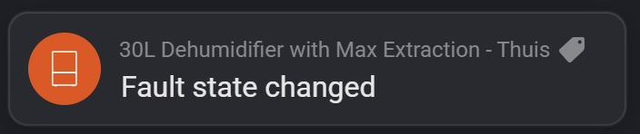

However, the device does not include any controls/buttons nor any sensors. The only sensor is called ‘Fault’ with no value. Also the only flow card available is a WHEN card named ‘Fault state changed’:
The advanced settings of the device does contain some settings related to my dehumidifier:
I am not sure what this means. Is my dehumidifier not supported by default (and hence I have to use the raw commands/tap-to-run options)? I assume that if a device is not supported, you cannot add it. Since my device is found and added, I assume it is supported. However I don’t know what I am missing/how to get it up and running.

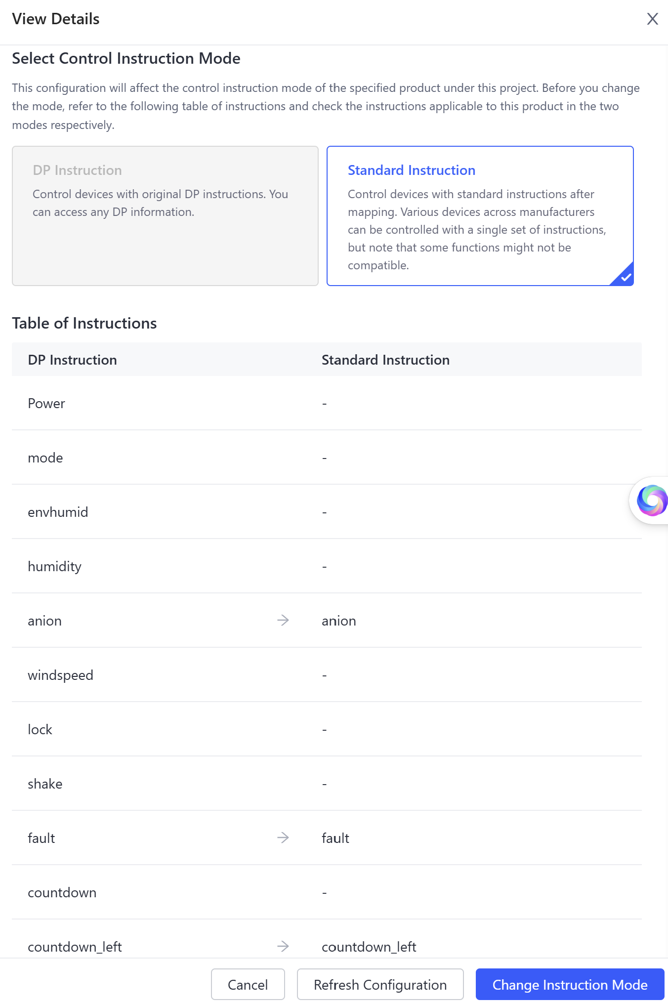

I learned that the IoT Core API apparently can use two different instruction modes:
  • Standard Instruction mode;
  • DP Instruction mode.

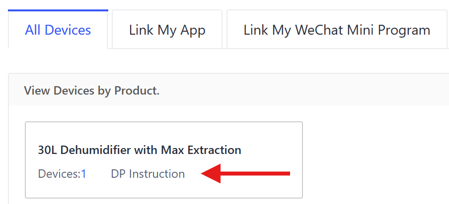

By default my device was set to the Standard Instruction mode. The active instruction mode is indicated on the device tile in the Device overview in the project:
You can actually see what the instructions (or functions or properties, if you will) are which are supported by each instruction mode, by clicking the eye icon in the device’s tile:
A panel opens that shows the instructions in Standard Instruction mode and also the available ones in the DP Instruction mode:
In my case only a few instructions of the ones actually available in the DP Instruction set were exposed/mapped to the standard set (right hand side of the image).
You can change the applied instruction mode via either the Change Instruction Mode button in the above panel or via the pen icon in the device tile mentioned earlier:
After changing the mode, the device tile now shows that the DP Instruction mode is active. Going back to the instruction panel again (via the eye icon on the device tile), now indicates that all available instructions are available for controlling the device. All DP Instructions are now mapped to a Standard Instruction:
The nice thing about this overview is that you don’t have to determine which instructions are available for your device, by intercepting them via the ‘Text message received’ WHEN card in Homey. Instead, the available instructions are listed in the above mentioned panel.
Also the Tuya Development Platform contains further information on those instructions, like the data type and allowed/expected values:
  • Goto Cloud > API Explorer > Select IoT Core in the navigation pane > Device Control (Standard Instruction Set) > Get the specification and properties of a device. Enter the Device ID and click the Submit Request button. then you get an JSON overview of the instructions and status properties, data types and expected values.
  • Alternatively: Goto Cloud > API Explorer > Select IoT Core in the navigation pane > Device Control > Query Properties. Enter the Device ID and click the Submit Request button. then you get an JSON overview of the properties, data type and their last value.
  • Tuya documentation on Standard Instruction sets per device type/category. This documentation also includes the possible values of each instruction.
These resources might help in figuring out the syntax of raw commands.

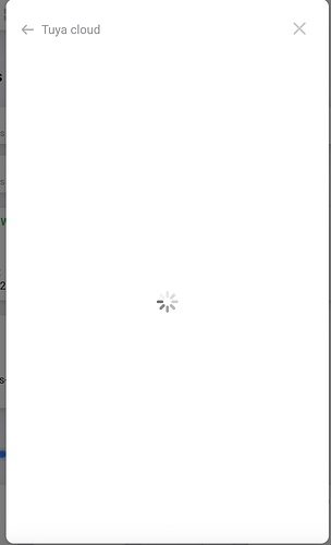

I completed all steps mentioned in the post. The device is in the TuyaDeveloper platform.. see
Adding it to Homey keeps getting stuck:
I’m not sure if it’s a native supported device, Willem. What device did you select to install?
But, by using the RAW Commands workaround you can get it"s data to Homey.
I’ve tried both CO-sensor and smoke-detector. Unfortunately neither of these give me results. Who can I contact to add the AJ-662 as a device?

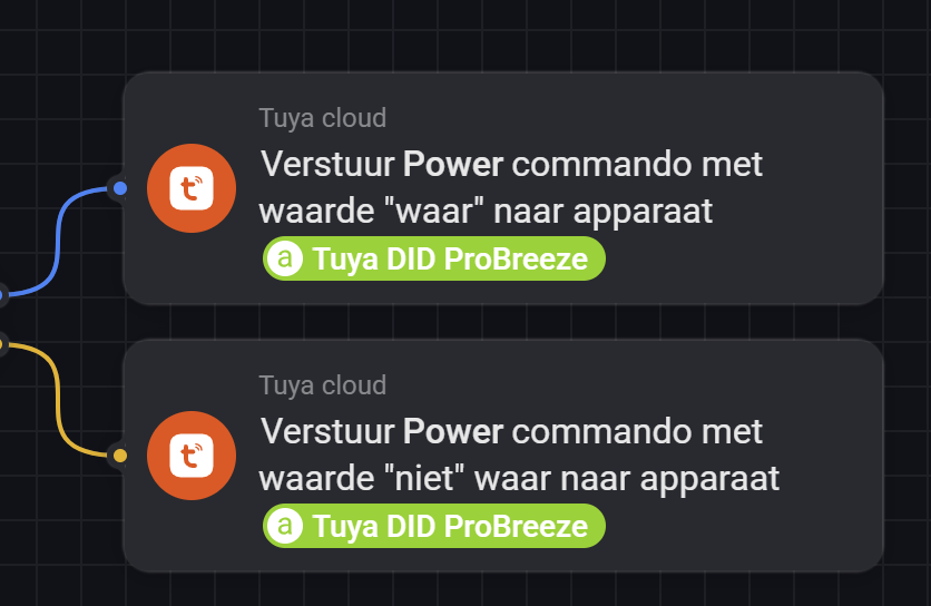

Just to give you an idea of how such a raw command looks like.
I have a dehumidifier that I control via those raw commands. Each button / sensor on the dehumidifier has a corresponding raw command to activate or read out the status. For this purpose the Tuya Cloud app provides dedicated flow cards.
As an example turning on and off the device. The raw command that tiggers the power switch is called ‘Power’, in this case. The switch can ether be turned on (true) or off (false). Those are the basic elements.
  • The first flow card turns on the device: it sends the Power command together with the ‘true’ (‘waar’ in the Dutch screenshot) state to the device.
  • The second flow card turns off the device: it sends the Power command together with the ‘false’ (‘niet’) state to the device.
Setting up such flows and (ideally) also setting up a virtual device (which also enables you to create insights) or dashboard that controls those flow via buttons, does of course require more time compared to a fully supported device. However it does enable you to use and control the device with Homey, which would otherwise not have been possible, when no support for it is available.
