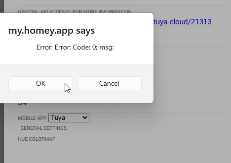

Hi, I’m having an error code 0 when trying to set it up
Any idea about it? I can’t add anything :frowning:
Thanks in advance!
